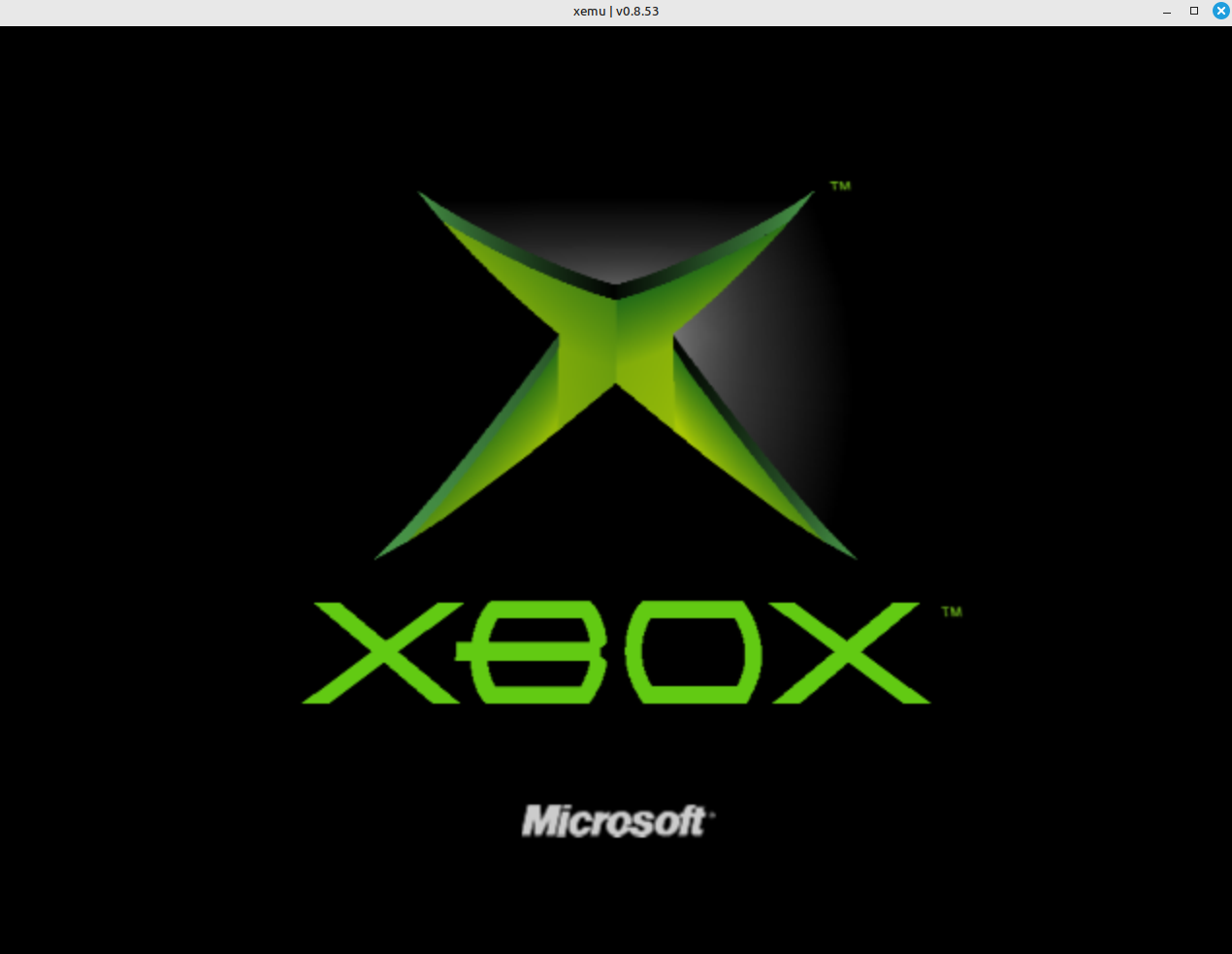

      2 - Once the emulator has installed you will need to head back to the desktop and before you run Retropie the emulator will need configuring the first time so type the following in terminal to bring up the emulator.
      /opt/retropie/emulators/xemu/xemu
      Once in the configuration just point to your bios files and hard drive image, set up anything else you need then from the menu you can exit. If you jump straight into Retropie and try load a game first time you will need to configure but for some reason i couldn't figure a way out of the configuration screen so had to hard exit which loses configurations. This is why you need to configure bios etc before you start.
      After this you can run games like any emulator on Retropie.

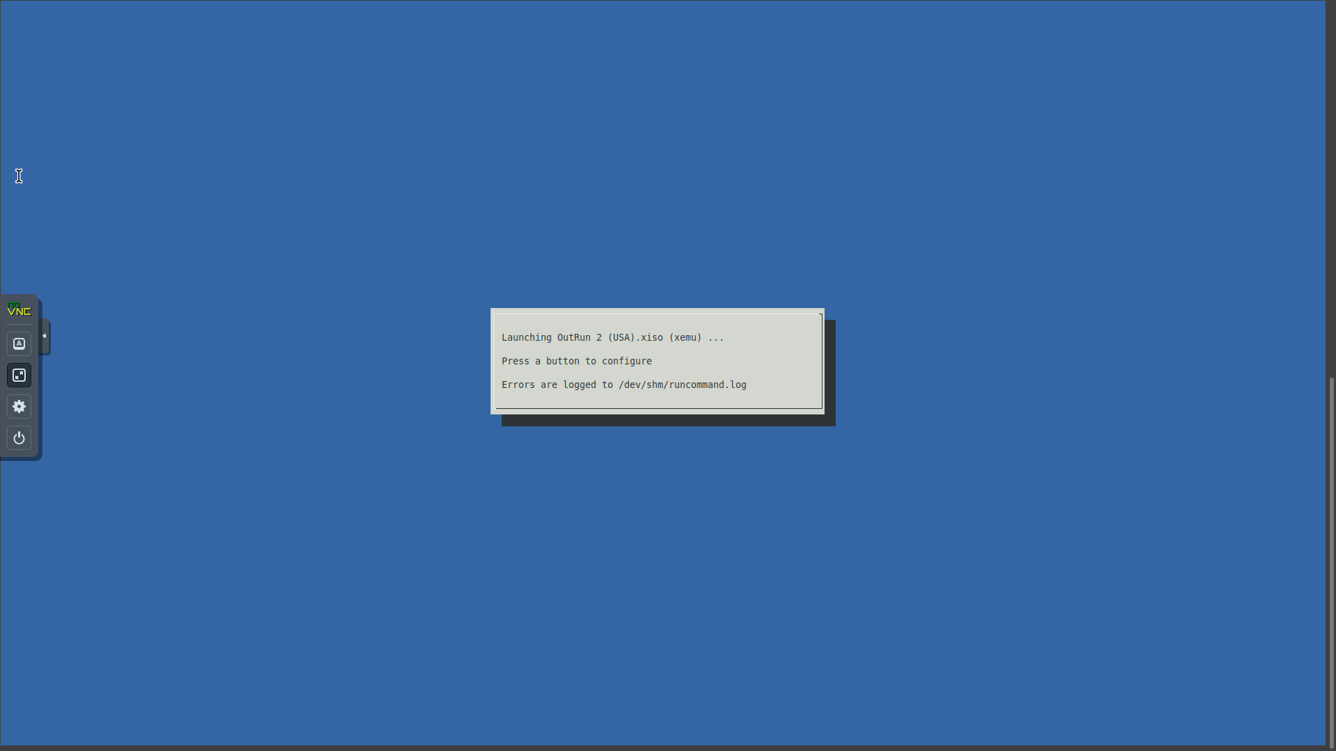

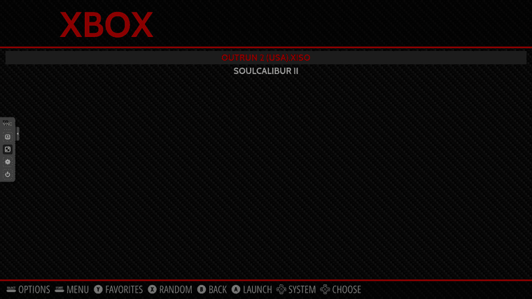

      SEGA CHiHIRO
      Xbox can play Sega Chihiro games on the OG console, according to information online you will need a 128mb bios to get any games at least loading (not primarily playable). ISO/XISO format is needed. When loading Xemu i tested with both 64mb & 128mb in settings and using both they gave me the same results with the photos below.

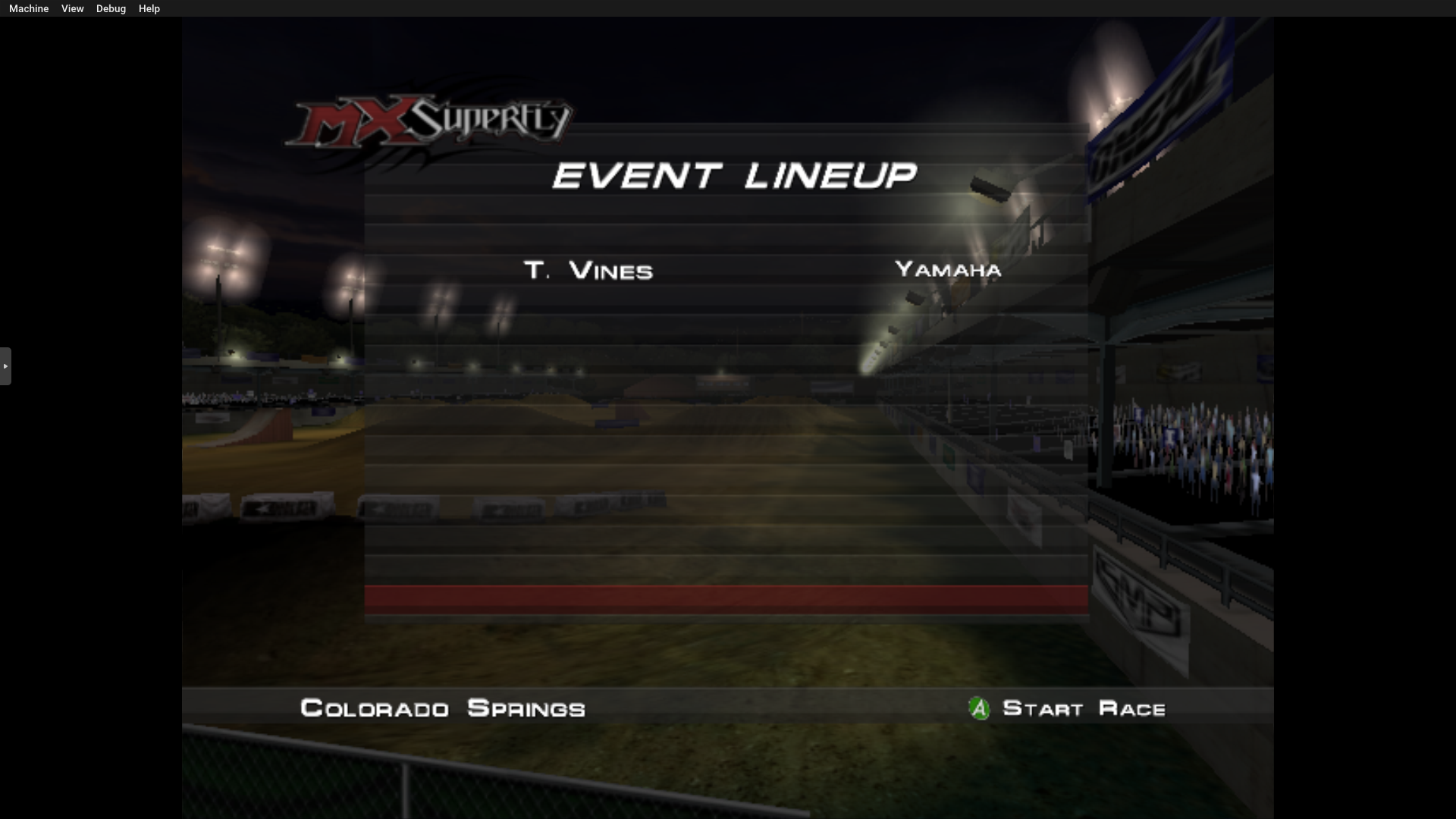

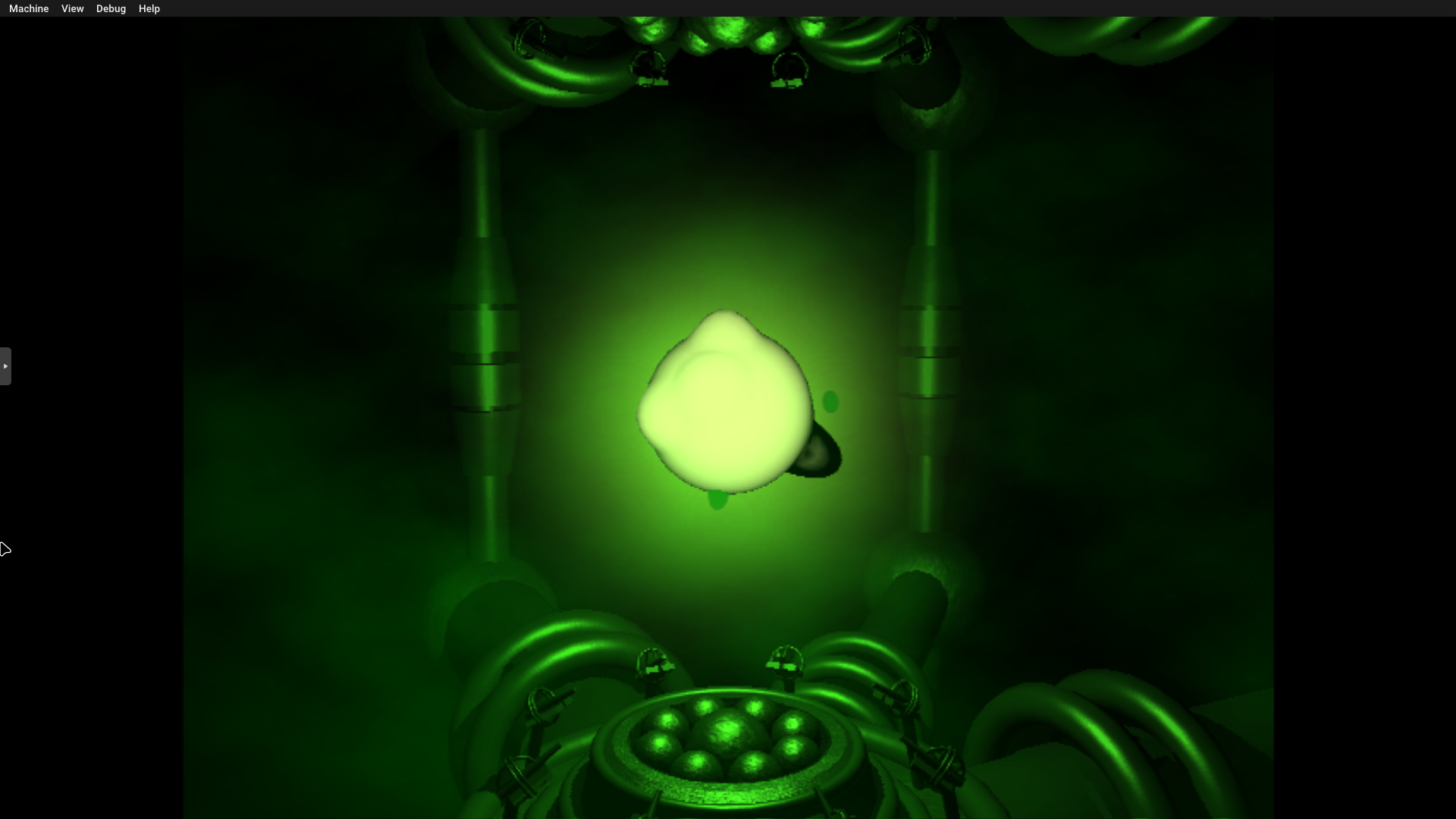

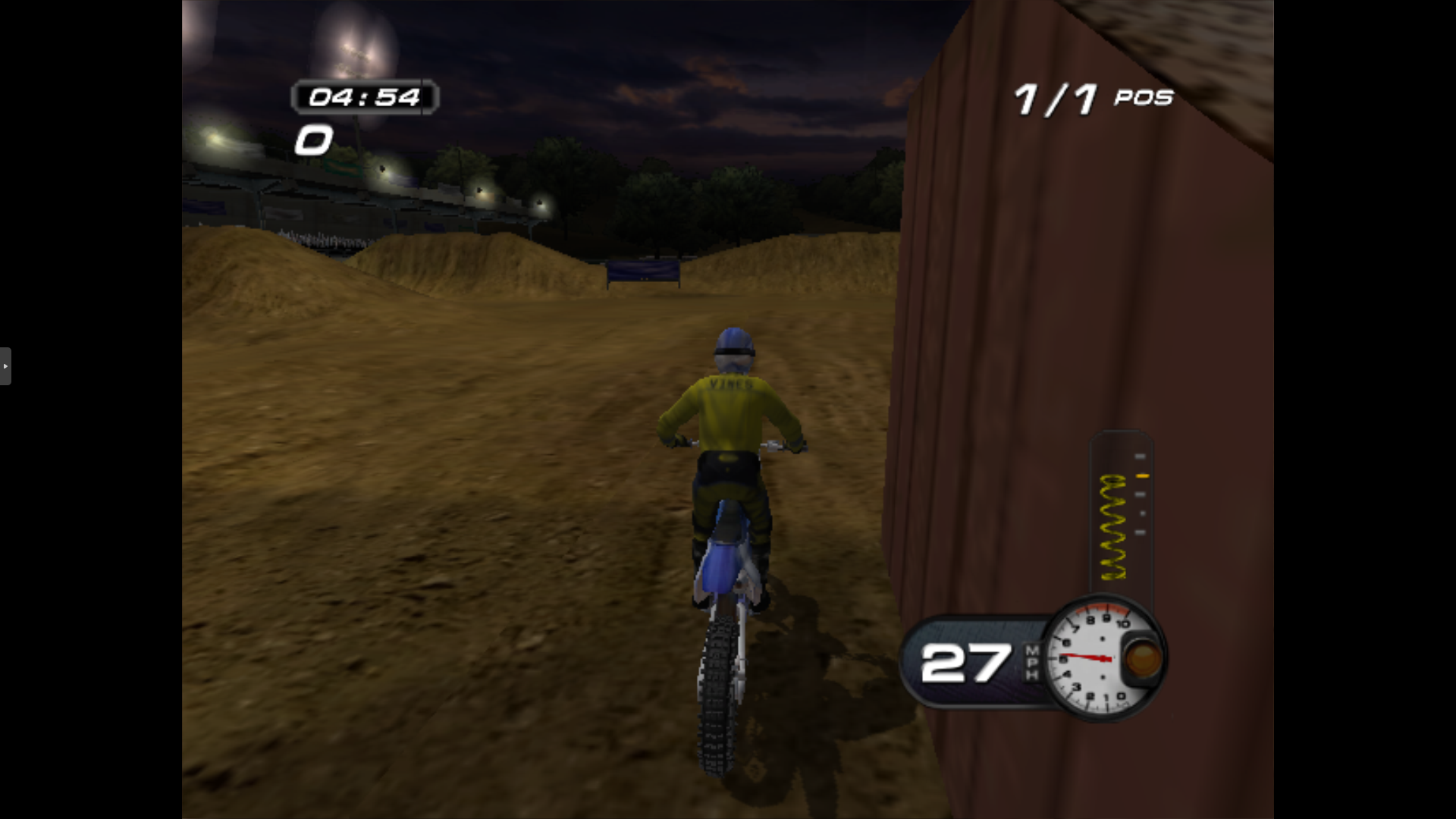

      Here are a couple of screenshots for you to show you
      SEGA CHiHIRO

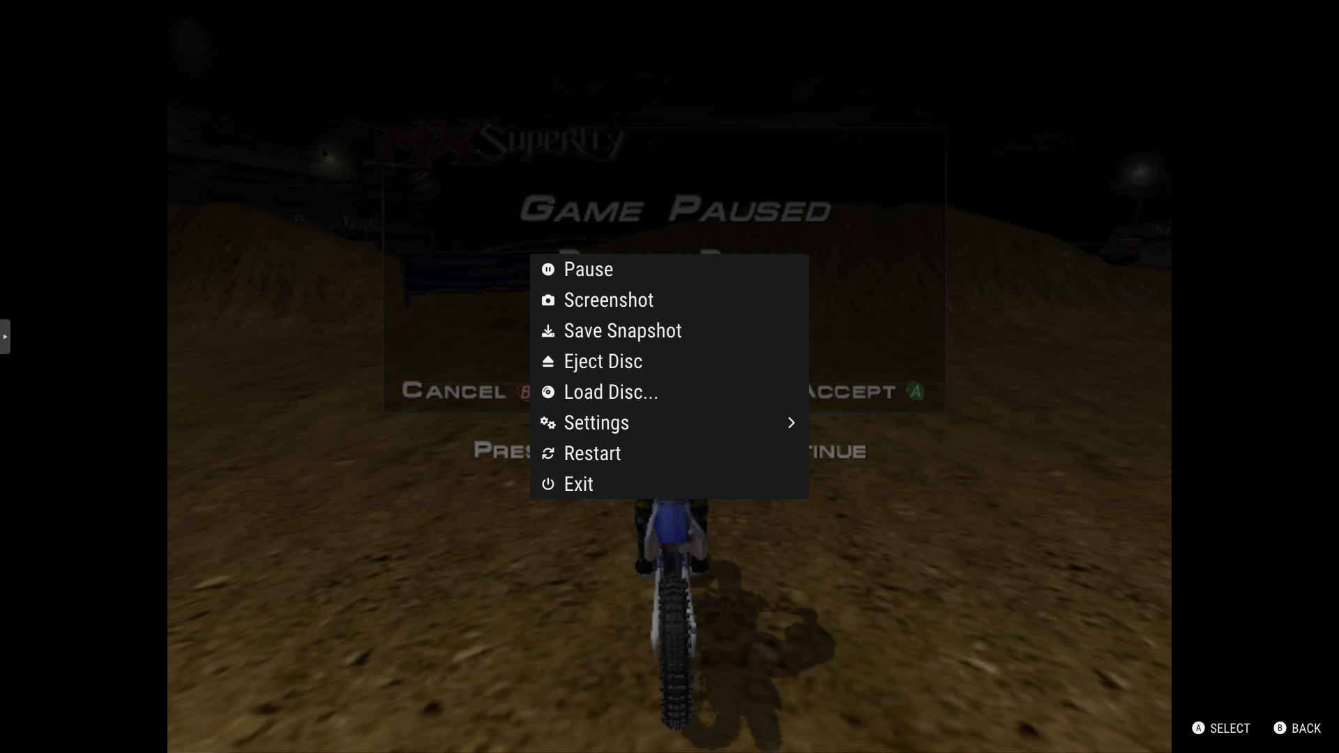

                        Snapshots
                        Ok so Xemu uses snapshots for game saves, when your in a game you press start, navigate down to snapshots on the menu and you can load or save a snapshot which is ideal for Retropie users but it would be better if it could be integrated with Retropie's save/load system for emulators so you wouldn't have to press start and open the snapshot menu to save.
                        Here is a link to the snapshots feature
                        https://xemu.app/docs/snapshots/
                        I don't know anything about the load/save feature of Retropie so it's beyond the scope of my knowledge until i spend some time learning but maybe it could be integrated or hooked into it in some way?
                        If anyone is super knowledgeable and would like to tackle it go ahead but i'll get some learning done and hope to figure it out.
