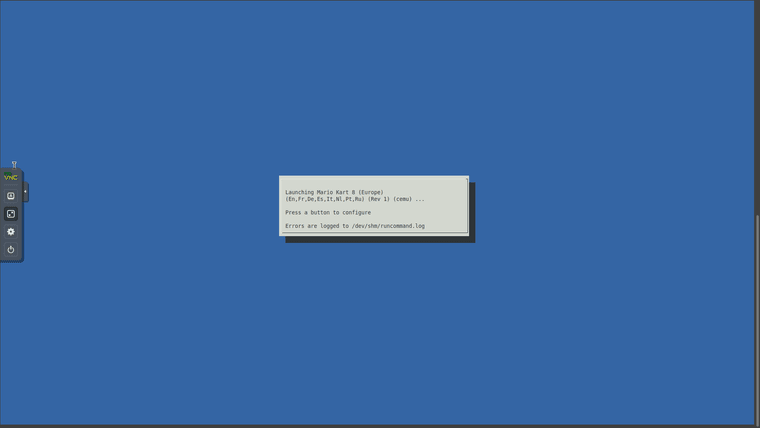

      1 - Emulator builds and installs and sets up a new system in Retropie
      2 - When you add a rom to the roms folder and run a game like any other system it just shows the emulator in a window
      It's progress but now i need to work out arguments and other such things. Feel free to take it, test it, add feedback and so on.
      A few screenshots below of my progress
