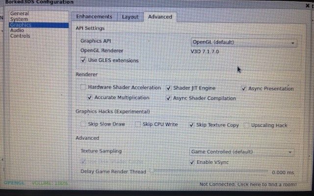

                Hi gvx64, I found a small bug in the user interface. In the configuration menu (configure..), a dialog box with all the options, such as graphics, appears. This box does not have a side scroll bar. So, when I use it on a small screen (e.g. 7.5 inches), I cannot access the lower options. Is it easy to add a scroll bar?
                DTEAMD G 2 Replies Last reply Reply Quote 0

                    @DTEAM I can take a look at it when I get the chance. It shouldn't be too hard to add a scrollbar to the config menu (hopefully that statement doesn't come back to haunt me).

                        @DTEAM OK, I implemented the configuration menu scroll-bar as an experimental feature. You should be able to enable it if you add the following cmake flag to your build script:
                        -DCONFIG_SCROLLABLE=ON
                        I have left this flag disabled by default in the CMake file because I am not sure that normal users with conventional screen size will benefit from the scroll bar. This feature does make you scroll to use the config menus whereas in the default implementation the text spacing auto adjusts which I think is preferable for most screens.
                        Please give it a try and please let me know if this works OK for you. I can make changes as needed.

                              This doesn't work well. A simpler solution could be to have an option to set the font and UI size. Previously, my UI was smaller. I played with some font settings, but the UI doesn't handle this well.
                              The problem is that I can't access the bottom of the menu where you can set the graphics options, so I can't click OK to apply my settings. It used to work fine, but I needed a magnifier to see the menu on my small screen.
                              Perhaps the emulator retrieves the Pi internal settings during software installation. Perhaps if I change the font settings of the Raspi UI and reinstall the emulator, everything will be fine.
                              FollyF G 2 Replies Last reply Reply Quote 0

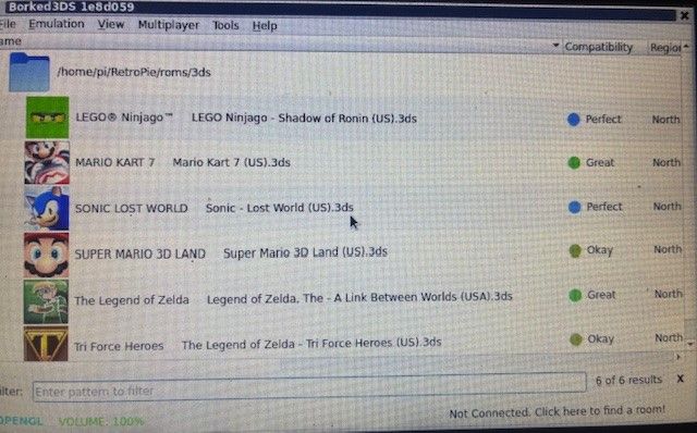

                                    @DTEAM Are the scroll bars showing up in your configuration windows? If not, is it possible that the cmake flags didn't work?
                                    It would help to see a photo of exactly what the problem is, as I am having difficulty understanding it. On my Pi, the configuration menu is a fairly small window that doesn't come close to filling the whole screen. Also, I can click and drag the menu border to change its size. In the default layout, the text spacing adjusts to fill whatever available space there is inside the window.
                                      @gvx64
                                      At the bottom of the second picture, the box of the Advanced tab stop just after 0.000 ms and it's not possible to go below that.

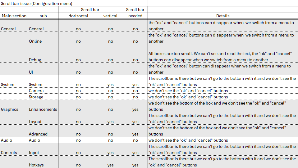

                                        @DTEAM After investigating further, the problem is on my end. I am going to re-work it and try posting a new commit. Is the problem limited to the Graphics -> Advanced tab or are there others? I believe that the System tab already has scrolling bars enabled.
                                        • DTEAMD
                                          DTEAM @gvx64
                                          @gvx64 said in 3DS emulator for Pi users based on "Borked 3DS":
                                          It's others. For some, you have the scroll bar, but even if you scroll down, you don't have access to all the options. I'll try to give you a more detailed overview tomorrow.
