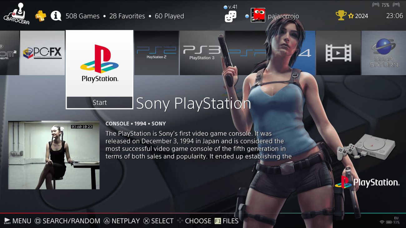

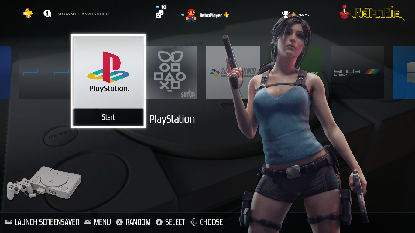

      I'm working on themes for EmulationStation and would like to request an improvement related to the carousel layout. Currently, the selected system logo is visually affected by the neighboring logos, making it difficult to center or fix its position precisely.
      In contrast, other forks of EmulationStation (like ES-DE / Batocera) allow the use of <selected> and <notSelected> tags inside the carousel, which lets you:
      Precisely anchor the selected logo to a fixed position on screen.
      Keep surrounding logos from pushing or overlapping it.
      Control spacing or alignment freely without relying on the number of logos visible.
      For example:
      In RetroPie: the selected logo is always the second or middle one, but its position shifts depending on how wide the other logos are.
      In ES-DE: you can set <selected> to always appear in the same fixed position, and the other logos slide independently.
      Here's a visual comparison:
      RetroPie (current)
      The selected logo is pushed by its neighbors, making themes with precise spacing more difficult.
      Desired behavior (ES-DE style)
      The central logo is fixed; the surrounding ones move. Clean, consistent layout.
