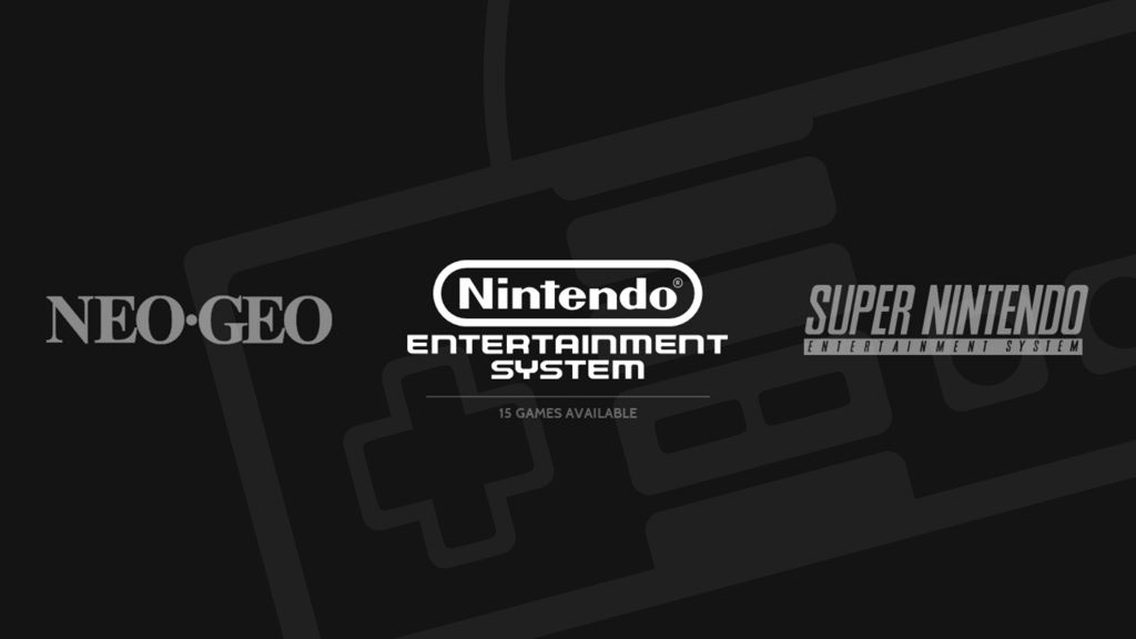

@jesseblue said in [Theme] Art Book:
I love this theme!! :D But i think the main menu is a little bit to clean.
Would something like this be possible with ES? The background image is from the "bichromatic pads" collection of retroarch.
Hello and thank you for such an ellegant theme.
Is there a way to have this background per system with the joypad activated?

@rek607 I had looked at this in the past and it caused some performance issues if I remember so I dropped it until I could find time to dive deeper into it. Sadly I haven't had time to revisit it. I don't think there is a way in retropie yet to add this as a configurable option.
