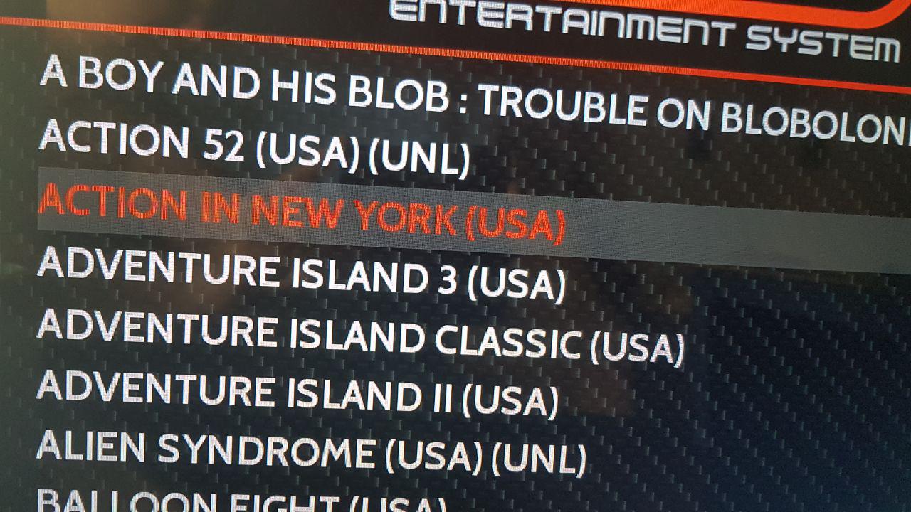

                Is there a way to change the output of the <name> tag that is written to the gamelist.xml file such that the country information is not shown in ES? It looks like it is currently using the file name of the rom. For example:
                Super Fun Game Deluxe (USA, Europe, Japan).zip
                should be displayed in the ES game list as
                Is this already possible? I looked throught the readme and the command line switches but didn't see anything relevant. Thank you!

                  @incunabula No, this is not possible at the moment. It is not actually using the file name. What it does is register any round and squarebracket "notes" as I call them. It then uses the web result title, and adds the notes back in.
                  I'll add a '--nobrackets' option in the next release that will disable the bracket tags. :) You will also be able to set 'brackets="false"' in the config.ini file under both [main] and [platform]. That should give you plenty of options for disabling it. :)
