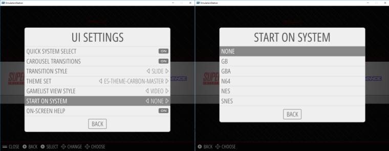

In the meantime, it is also possible now to configure ES to start inside a specific system, which is not the same, but similar to what you want:

This isn't a solution and I haven't tried it but as I thought through the ES options I wonder if this would work.
Setup a custom collection with the games you want included in that collection.
Then turn on "Start On System" to be that collection.BTW, I haven't seen the "Start On System" option yet but I'll take a look at it this evening .
