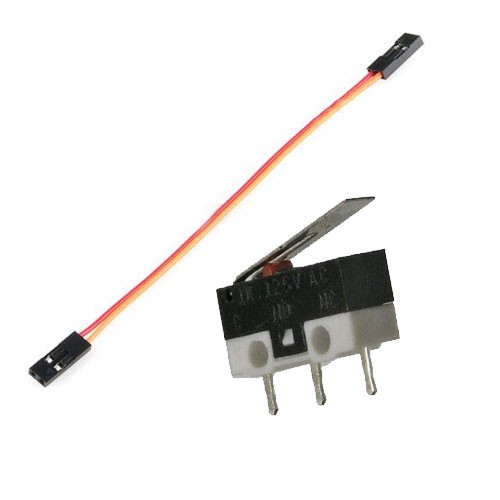

              Another question, I will use the encoder for the retrogaming, and I want to add a microswitch. Can I use a female-female 2-pin jumper wire instead of the provided cable? I'm asking because the switch I have has this pins, like a jumper wire

                caver01 @The Walker
                @the-walker You can use anything that conducts electricity. I would not recommend taping spoons to your switch, but it would work if you could keep them in contact with your pins!
                I used spade-style crimp connectors on my microswitches and crimped them to both ends of CAT5 network wires which were easy to distinguish from one another due to the orange, white, green, blue, brown. This also kept everything nice and neat while allowing custom lengths.
                T 1 Reply Last reply Reply Quote 0
