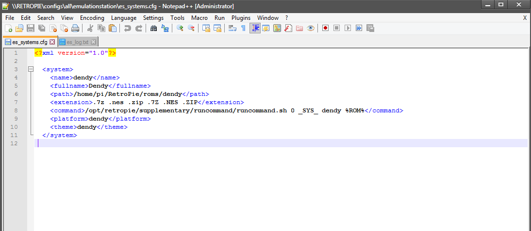

          @mitu yeah so I'm not getting anything showing up at all. I even changed the theme of RetroPie back to Carbon just to be safe. I am guessing it has to do with the homemade es_system.cfg file I made. The only thing I added inside of it was the Dendy system info... Any ideas? I found an es_system.cfg file from a pre-made image I was thinking about trying it, but I don't wish to harm my image in any way as it is a 400gb SD card and it would suck to rebuild it. I know I need to back it up, but good lord that is a ton of drive space.
            mitu Global Moderator @Cyborgbob
            @Cyborgbob Without a log file and/or a screenshot to show the problem, it's hard to guess what the problem is or suggest a solution.
            Post your modified cfg on pastebin.com and the log file at least.

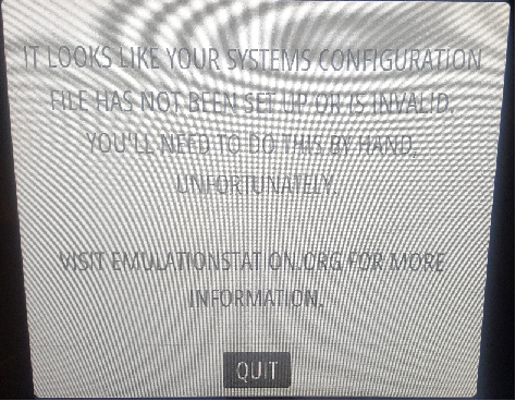

              So the log seems really short so I hope it is cool just to post it here:
              lvl2: EmulationStation - v2.7.6rp, built Jan 5 2019 - 22:02:06
              lvl2: Creating surface...
              lvl2: Created window successfully.
              lvl2: Added known joystick Microntek USB Joystick (instance ID: 0, device index: 0)
              lvl2: Added known joystick Microntek USB Joystick (instance ID: 1, device index: 1)
              lvl2: Checking available OpenGL extensions...
              lvl2: ARB_texture_non_power_of_two: MISSING
              lvl2: Loading system config file /home/pi/.emulationstation/es_systems.cfg...
              lvl0: es_systems.cfg is missing the <systemList> tag!
              lvl0: Error while parsing systems configuration file!
              Here is a copy of the es_system.cfg like I said earlier I did not have one in the spot that the link told me to look so I made my own only adding the info I wanted.
              And here is a copy of the message my pi gives me when I try and boot with the modified es_system.cfg file in.

                  @Cyborgbob not only do you need the <system> lines for that system, but you need the beginning and end <> info for the whole config
                    @Cyborgbob The file is - largely - incomplete. You need to get a copy of the system's config file first and modify it. As the page I indicated says, you need to copy the /etc/emulationstation/es_systems.cfg to /opt/retropie/configs/all/emulationstation first, and then modify the file.
                    The /etc/emulationstation/es_systems.cfg is not available via file shares, you must exit Emulationstation and copy it with either the file manager (type mc) or directly from the commandline:
                    cp /etc/emulationstation/es_systems.cfg /opt/retropie/configs/all/emulationstation
                    After doing that, you'll see the complete file via File Shares and you'll be able to add your modifications - like the doc said.
                    CyborgbobC 2 Replies Last reply Reply Quote 1
