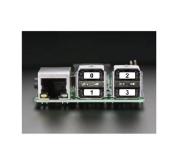

            mahoneyt944 @Vlak6
            Do you have player 1 going to usb port 0 and player 2 going to usb port 1?
