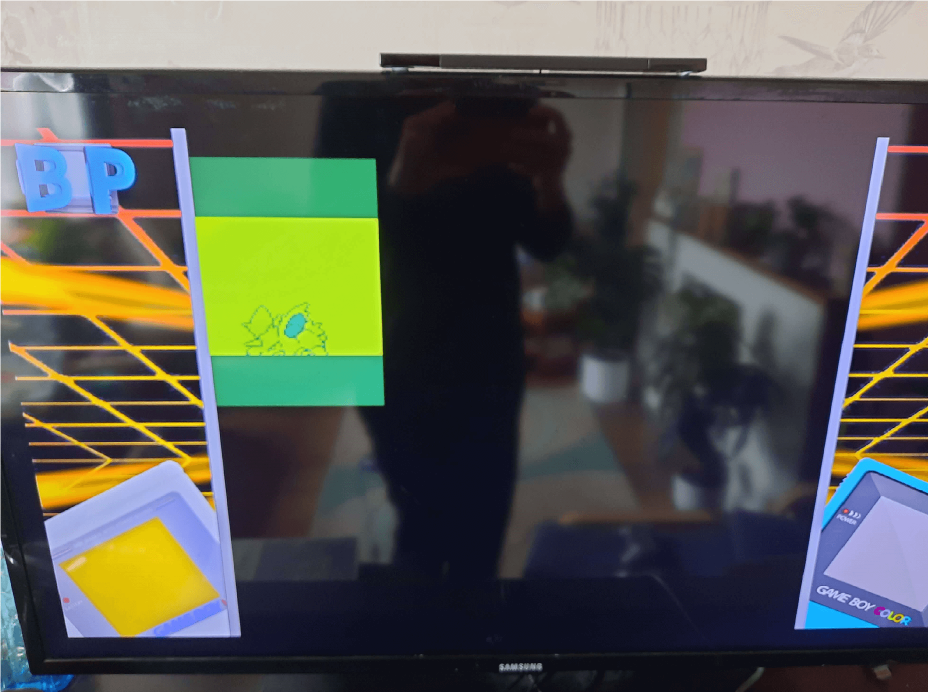

      Hope someone can help:
      The emulators for both Gameboy and Gameboy colour seem to shove the screen in the top left corner, as shown:
      Weirdly, when pausing the screen it displays the game back in optimal resolution through the menu:
      I can't say for certain this has caused it, but I have recently installed this script which places bezels on all systems. (I didn't test the systems before installing the bezels):
      https://github.com/thebezelproject/BezelProject
      A quick google says that editing the cfg for the GB emulator may fix the problem, but it doesnt seem to be doing anything:

        I'm trying to see where your problem is, but the info you provided doesn't help.
        What file did you pull that info from? When any libretro emulator is loaded, it will generate it's own retroarch.cfg file in the emulator's directory.
        so you'll get /opt/retropie/configs.hdmi/gbc for Gameboy color, and a retroarch.cfg in there that will override the global retroarch.cfg in /opt/retropie/configs.hdmi/all
        where is the content you posted from? That setting info is basically saying that you want to use an overlay, what overlay and where it's located. Also, how transparent it will look.
        The the next line could be the issue, but it's already disabled with "#". But setting a viewport that is core provided sometimes causes issues like this. The rest of the info is just the size and position of the view box. So those can all be tweaked.
        Try this... go into your retroarch menu like you did... go to the main menu and select settings... then VIDEO then SCALING... is "Interger Scale " enabled? if so, turn it off. Then change "aspect ratio" to "custom". From there work the screen to the size you want and see if that works. Don't save it yet, I just want to know if that changes anything.
        A stock scale of 640 x 576 is tiny on a 1080p screen. That could be the problem.
        Mine is 922 wide by 835 high on my settings for example. By the look of your overlay, yours should be even bigger than mine. I have what looks like a Gameboy bezel, so the screen is centered with the Gameboy surrounding it. Yours is open on top and bottom with only the sides being the graphic.
        One last question... what version of Retroarch are you using? Easy to find out... go back to the main menu... select "HELP" and look on the bottom left of the menu screen.

          Okay, you've pointed me in the right direction. I've never dabbled with Bezels before so its all new to me. Sorted out the scaling and all is well xD
            sleve_mcdichael @deanoiv
            @deanoiv try aspect_ratio_index = "23". A previous retroarch update changed the numbering of some of the indices; it's just the selection's position on the list when you select "settings > video> scaling > aspect ratio" in the GUI, remembering that the first item's index is zero. "Custom" is 24th on the list, making it index #23. Somewhere along the line, they added a new resolution to the list but they didn't update the documentation.
            You also don't need the custom viewport at all. You can remove or comment out (put a # in front of them) the aspect_ratio_index line and all of the custom_viewport_* lines, and the display should be full-height and centered (unless you have integer scaling on, then it'll be the tallest integer-multiple height that can fit on your display: ex. for Gameboy that would be 144 x 7 = 1008 pixels with a small black border on top and bottom if you're on 1080p.)
