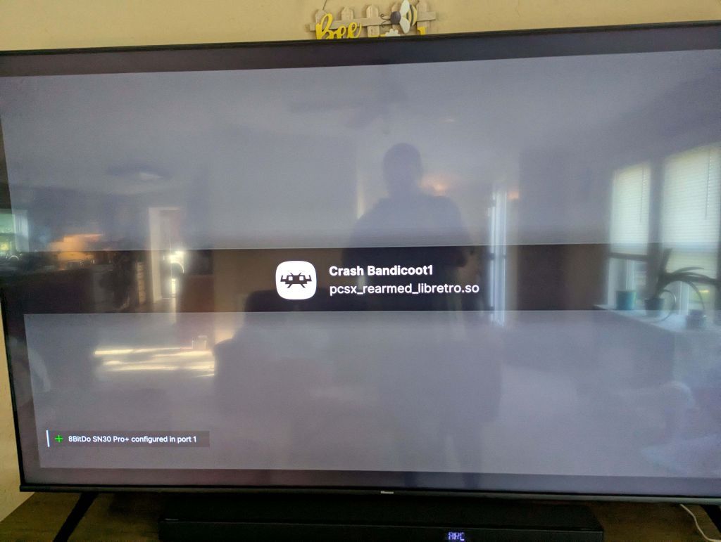

          fscii @sleve_mcdichael
          @sleve_mcdichael I had retroarch take a screenshot but it only came out black maybe it won't take a screenshot of an overlay itself is making? Anyway I took a pic w/my phone and here's what I'm seeing.retropie_4.8.jpg -- trying to eliminate the controller announcement and this entire screen. I don't plan on using splash screen images unless there's no alternative.
            sleve_mcdichael @fscii

            @fscii said in remove game launch screen with rom title + emulator retropie 4.8:
            Aye, that's the "load content" startup notification setting in RetroArch. On by (retroarch) default but should be disabled by retropie basic setup. Since it's not disabled, I fear you may have jimmied your config. Does it (/opt/retropie/configs/all/retroarch.cfg) begin with (and look like a) ## Skeleton config file for RetroArch with notes and comments, or is it more just like a wall of all settings?
                @fscii I think you missed one. menu_show_load_content_animation = "false" should disable that "Crash Bandicoot1/pcsx_rearmed_libretro.so" banner.
                    This is all at the end of the file: /opt/retropie/configs/all/retroarch.cfg
                    That does all look correct so maybe you have an (core/game) override somewhere. Try launch with verbose logging (you have to go turn runcommand launch menu back on, then use the launch menu to enable verbose logging at launch.) After launch, go check the log at /dev/shm/runcommand.log and check any .cfg files referenced therein that may have these still set to true.
                      @sleve_mcdichael good call! /salute
                      I tried this:
                      pi@retropie:/opt/retropie/configs $ grep -r "menu_show_load_content_animation" .
                      ./all/retroarch.cfg:menu_show_load_content_animation = "false"
                      ./psx/retroarch.cfg:menu_show_load_content_animation = "true"
                      so my next question is how did that get there lol what did I do unwittingly or is that some default?
                      I did recently mess with some settings in retroarch in the psx core and save it.
                      Ok update: Launching didn't show that screen but then things get weird.
                      1. on lower left it still announced my joystick (how do I stop that?)
                      2. It announced the creation of a new retroarch.cfg (!)
                      So I exited the game to see what that would do and re-launched. That gray menu came back in the new retroarch.cfg for that core (the only core installed at the moment).
                      side note: it also told me I have no bios file when I did that. time to restore the backup.cfg and add in the needed text. So every core (or retroarch) creates retroarch.cfg in the folder of each core. Mysteriously it changed the option to show that screen and I wish I looked but I already replaced the backup -- to see what if else it changed.
                      good grief!

                        mitu Global Moderator @fscii
                        It's a RetroArch default, but RetroPie sets it off in the main configuration file. However, if you've used the RetroArch menu at some point the in the past to either save your config or reset the config, then RetroArch writes a full .cfg file and mainly ignores the main retroarch.cfg file.
                          That might have done it. RetroPie kind of does its own thing with configs and expects retroArch to stay mostly hands-off. When RA writes the saved config, it may have clobbered that special RP touch.
                          Instead of save config in RA, you are meant to use the RP configuration editor, or manually edit the config files; except remaps (and shader presets?), those are still fine to save in RA.
                          https://retropie.org.uk/docs/Configuration-Editor/
                          The psx/retroarch.cfg should be a very minimal file with just a couple of lines and then has a redirect back to all/retroarch.cfg for the rest of it. If instead yours looks like a big wall of settings, you can use the same trick with copy the retroarch.cfg.rp-dist but this time, reinstall the psx core lr-pcsx-rearmed, instead of retroarch, to generate the default file if it don't exist.
                          # Settings made here will only override settings in the global retroarch.cfg if placed above the #include line
                          input_remapping_directory = "/opt/retropie/configs/psx/"
                          #include "/opt/retropie/configs/all/retroarch.cfg"
                          F 1 Reply Last reply Reply Quote 2
