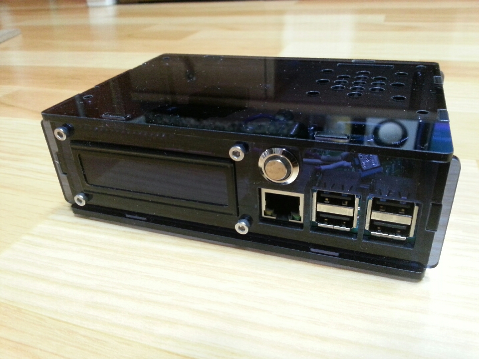

      This project was developed with my awesome friends(smyani, zerocool, superstar) in Raspberrypi Village and raspigamer
      We've made small script written in python for RetroPie project running on Raspberry Pi 2,3, which displays all necessary info on a 16x2 I2C CLCD display
      Please let me know what I missed bugs or to improve functions.
      Thanks to @meleu @obsidianspider @BuZz for good idea and tips to give me in RetroPie forum.
      Please see below photos of RAS Console-Pi:

      Features
      • Support 16x2 I2C Character LCD
        • Current date and Time, IP address of eth0, wlan0
        • CPU Temperature and Speed
        • Emulation and ROM information
      • Luxury case(width 150mm * height 100mm * depth 50mm ) using smoke color acrylic
      • Raspberry Pi On/Off power control using push lock led switch
      • 5V DC fan for the RPi's cpu temperature
      CLCD Development environment
      • Raspberry Pi 2, 3
      • RetroPie v4.0.2 and later
      • 16x2 I2C Character LCD
      • Python 2, 3

            It's a special RAS Console-Pi!!
            it's awesome in real....

                        @zzeromin Amazing job! looks beautiful.
