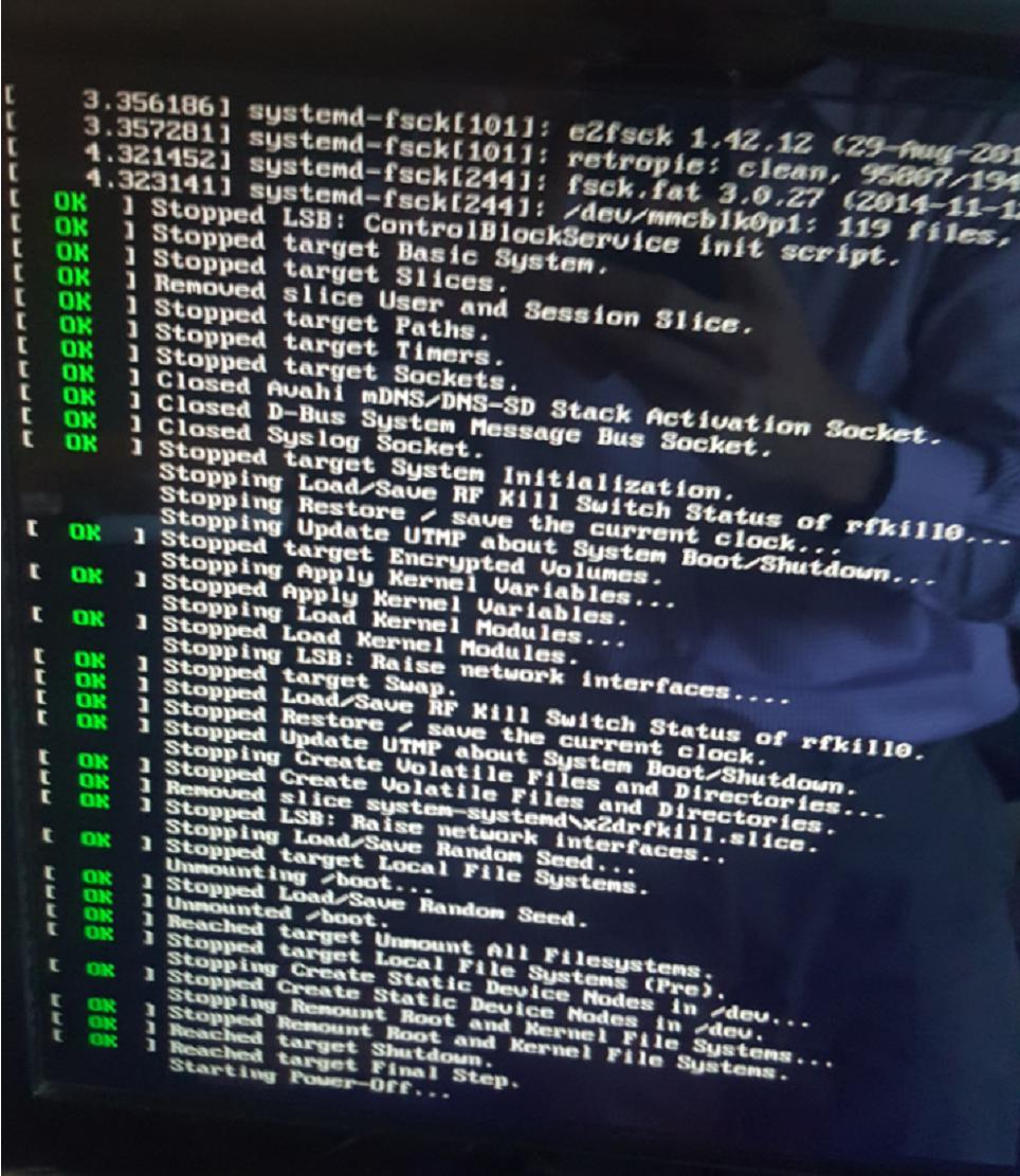

      Got all the way down to starting the service
      Step 17. Install the service so that the driver is loaded on boot: sudo make installservice
      but then the strangest thing the RasPi3 restarts then shuts down
      i have attached a pic.
      did i do something wrong here ?

      please excuse the image i had to take a snap before it turned off

        Hey all
        i managed to come right and thought i would share my findings
        in this situation the device needs a n on off toggle switch
        i used an on off switch on the power block pins and was able to boot and turn the device off.
        the installation and instructions on the site work perfectly.
