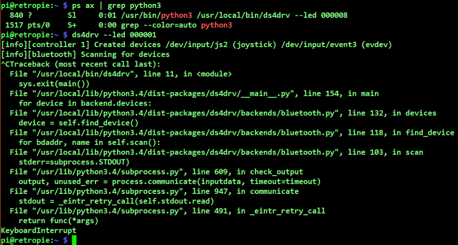

      I would appreciate if someone could shed some light on my issue. I was able to install and configure RetroPie 4.2 on my RPi 3B but got stuck with connecting my DS4 controller. I followed the guide but in order for me to use it I have to do the following:
      1. I type "ds4drv --led 000001", it says scanning for devices (If I don't press CTRL+C, it would stay like that forever)
      2. I press CTRL+C, it throws a bunch of errors and then... right below all those errors it says that controller is connected (it doesn't say that on my screenshot though)
      3. I type "emulationstation", my DS4 works fine in menu and in games
      However, if I don't perform those 3 steps, it doesn't work after the reboot. I made sure that the statement from rc.local works. Also, I removed and reinstalled DS4DRV and still having the same issue. I tried it with 3 different dualshocks - same effect.
      Thank you in advance!
        BuZz administrators
        please post your /etc/rc.local

            BuZz administrators @ALNiKO
            @ALNiKO Please use markdown when posting configs btw(use a code block) - see https://retropie.org.uk/forum/topic/3/read-this-first
            config looks fine though - so not sure what the problem is - do you have any other device drivers installed ? eg make sure ps3 controller driver is not installed.
