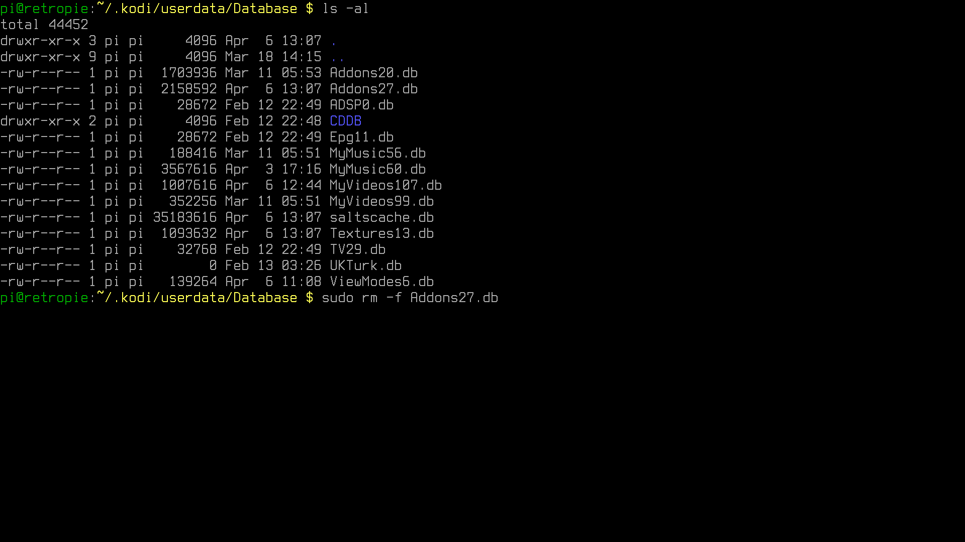

                              AlexMurphy Banned @paullew17
                              @paullew17 The first command is changing you to the correct directory. If you just use the second command you are trying to delete a file that doesn't exist in the current directory. Enter the first command again then enter then ls -al Post the output here. It should be a list of files in the Database directory.
                              • AlexMurphyA
                                @paullew17 It should look like this
                                  paullew17 @AlexMurphy
                                  @AlexMurphy Hi Alex, thank you once again for your help and Im really sorry but im still struggling. It is highly likely this is me being dumb but I get the terminal prompt as you show in your screenshot (I do get a dollar sign after pi@retropie though).
                                  I then type cd / home/pi/.kodi/userdata/Database (with a space between cd and the slash, and again between the slash and home) but nothing happens. It just drops to the line below. Ive tried variants of the command such as home/pi/.kodi/userdata/Database, or pi/.kodi/userdata/Database and even just kodi, but i either just drops a line or says its a directory.

                                    BuZz administrators @paullew17
                                    @paullew17 there should be no space between the slash and home in the path.
                                    P 1 Reply Last reply Reply Quote 2
                                      paullew17 @BuZz
                                      @BuZz legend!! it worked!
                                      I believe I have successfully removed the file now, I got to the right directory and used the ls -al command to see the file list. I used the removal command and then ran the file list command again and the file was missing! Brilliant!
