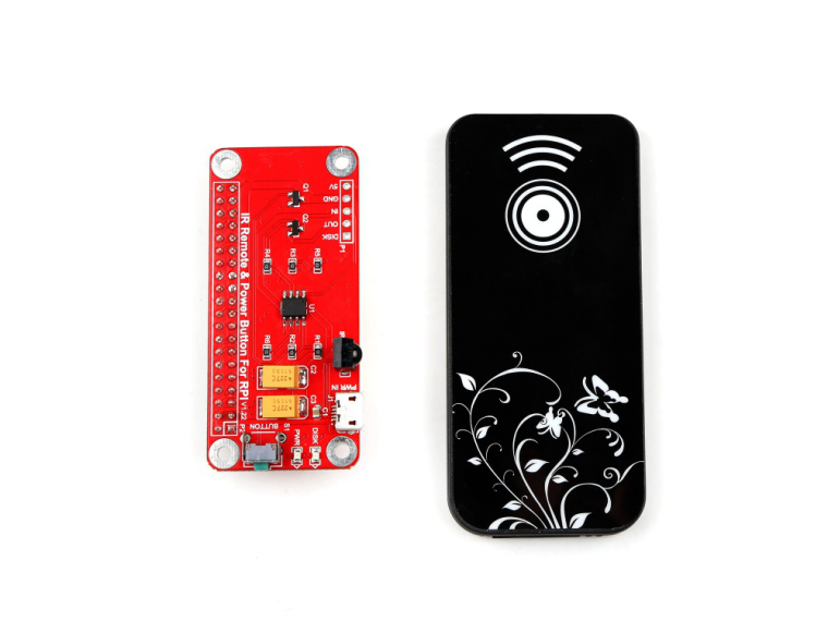

                        Have you or anyone heard of this http://www.ebay.com/itm/IR-Remote-Control-Switch-Module-Power-Button-Module-for-Raspberry-Pi-3-2-Model-B-/222412691189?hash=item33c8d456f5:g:CaQAAOSwTuJYprud.
                        It looks like it should work, anyone know if it needs script? Or does anthing you do need script? Thanks again

                        • DorkVonWaterfallD
                          DorkVonWaterfall @relivingthepast
                          @relivingthepast
                          http://wiki.52pi.com/index.php/Power_Button_For_RPi_SKU:_EP-0077
                          How to set it up
                          1. Remove your TF card and connect it to your PC or laptop with TF card adapter.
                          2. Modify /boot/config.txt file as following, for example, my pi is Raspberry Pi 3 model B:
                            device_tree=bcm2710-rpi-3-b.dtb
                            dtoverlay=power-off,gpiopin=26
                            dtoverlay=pi3-act-led,gpio=21
                            NOTE: device_tree=PARAMETER is depends on your Raspberry Pi's model.
                            more info please access this link:
                            [Device Tree| https://www.raspberrypi.org/documentation/configuration/device-tree.md]
                            Raspberry Pi model Device_Tree Info
                            Raspberry Pi B : device_tree=bcm2708-rpi-b.dtb
                            Raspberry Pi 2B : device_tree=bcm2709-rpi-2-b.dtb
                            Raspberry Pi B+ : device_tree=bcm2708-rpi-b-plus.dtb
                            Raspberry Pi 3 B: device_tree=bcm2710-rpi-3-b.dtb
                          3. Install the library of wiringPi and Download shell script to check the GPIO pin's status:
                            sudo apt-get install -y wiringPi
                            cd ~
                            git clone https://github.com/yoyojacky/powerbutton.git
                            cd ~/powerbutton
                            sudo mv ~/powerbutton/gpioshutdown /etc/init.d/
                            sudo chmod +x /etc/init.d/gpioshutdown
                          4. Edit the initialized file in /etc/rc.local :
                            sudo nano /etc/rc.local
                            Add those three lines before exit 0
                            sudo /etc/init.d/gpioshutdown
                            gpio mode 25 out
                            gpio write 25 1
                            After edit this file, Press "Ctrl + X" to save this file and Press "Y“ to save it.
                          5. Reboot your Raspberry Pi and plug power button on your RPi, press the button to test.
                            Have fun.

                            That looks awesome! It looks like the power on-off switch will work with a momentary switch! Thats amazing, the powerblock needs an always on toggle, this could REVOLUTIONLIZE my atari builds, hahaha. I'm going to order one and try it out.
                            Vector Artist, Designer and Maker of Stuff: Laser Cut Atari / Pixel Theme Bartop
                            CapemanC 1 Reply Last reply Reply Quote 0
                            • CapemanC
                              Capeman @Capeman
                              ... But i will need to desolder that IR sensor and put it on a wire, what an odd placement, You'd think that would come as a separately mounted piece. But still, this excites me! If it works, this will be my replacement for the powerblock, and the price is right too!
