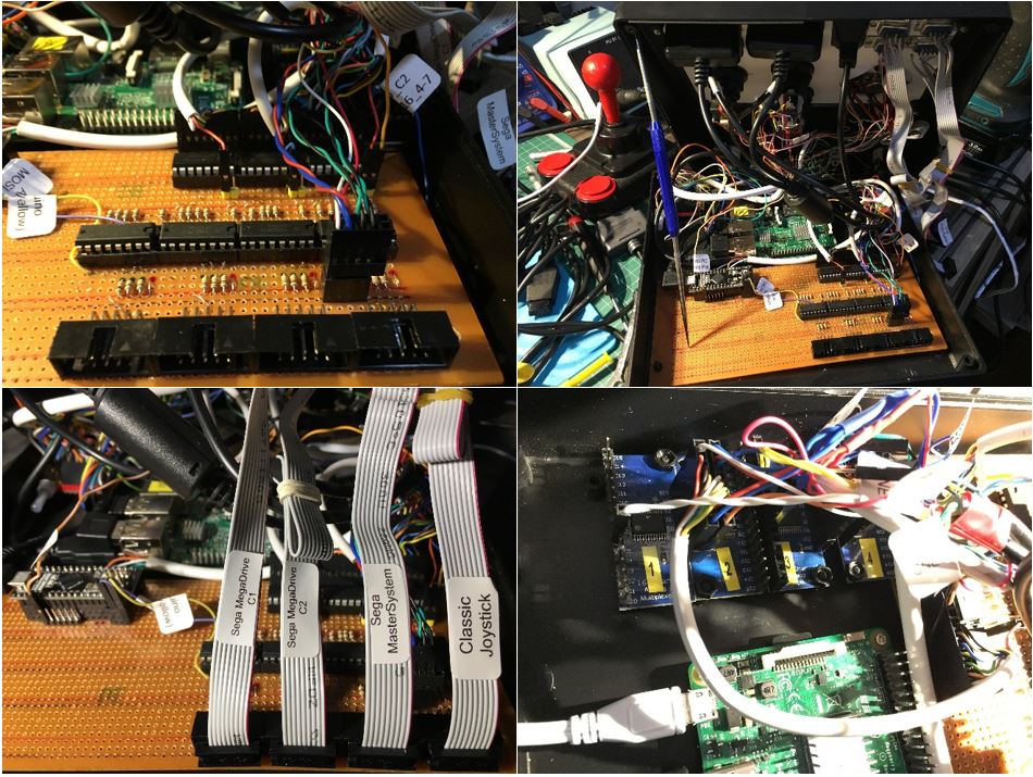

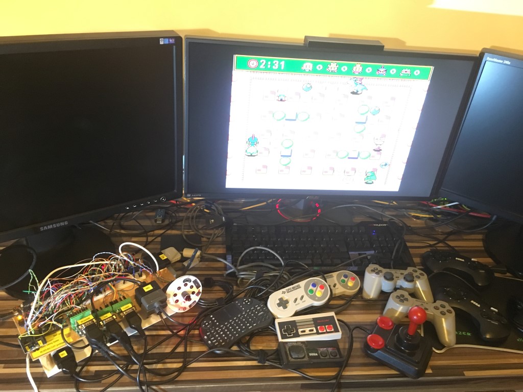

This is a photo of an early build, the circuit for all the controllers is still on a breadboard

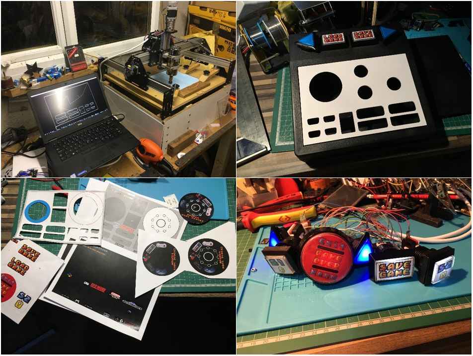

Photos of the PCB, internals, milling the front panel, buttons etc
