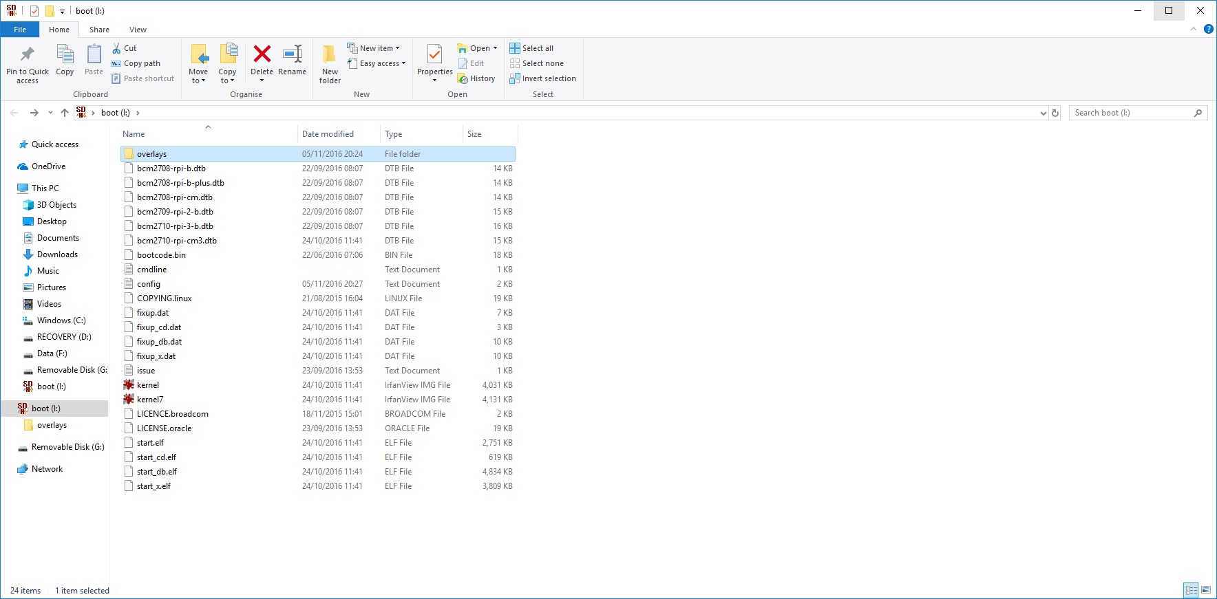

                              Hi Simonster, I have tried using both Etcher and Win32diskimager. The SD card seems to have the files written to it, I'm worried that I may have formatted the G drive and removed files that were necessary for the workings of the pi3b+ . is that possible?
                                KiDCy @KiDCy
                                @kidcy said in starter pack memory problemo :(:
                                here's a picture of what has been put on the sd card 0_1523094098468_sd card.jpg

                                  Thank you Jonnykesh. I've actually got retropie (pi3b+ beta) running! Nice to finally see something on screen!
                                  Now to try and get some games :)
