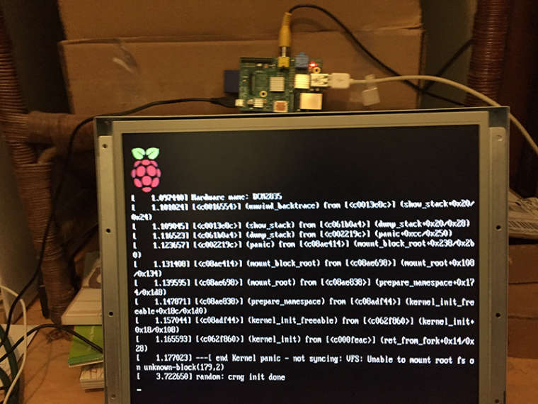

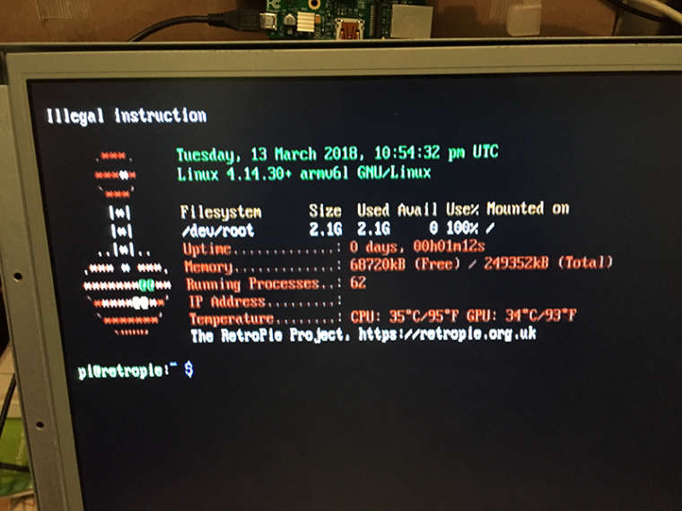

      One gets me to this0_1524946301164_IMG_4480.JPG The other got me here 0_1524946327556_IMG_4483.JPG

          I have 2 SD cards and I've installed both versions on each one. Neither will install.

            @revtommy what do you mean by both versions? looks like you are using a Pi1 which needs the pi1/0 image.

              @lostless I have two SD cards with retropie-4.4-rpi1_zero.img. The other with retropie-4.4-rpi2_rpi3.img. Both are formatted 16 GB cards. Neither version will install.
                You need only the Pi1/0 image, which I assume it's the 2nd screen. What's problematic, looking at the 2nd screenshot, is that your usable space is 0 bytes.
                Run raspi-config and expand your filesystem, then re-install using the RetroPie-Setup script all packages (do an update). What cards are you using ? Are you sure they have enough capacity ?

                      @mitu I have model B Rev 2. When I try to expand I get "There was an error running A1 Expand Filesystem". I'm using a 16GB SanDisk

                          @revtommy Dump question? Is the write protection switch disabled? It is not uncommon that if you insert the SD card the write protection switch can be enabeld by accident.
                          Anyway: you can run sudo raspi-config and it should work to expand file system ;)
