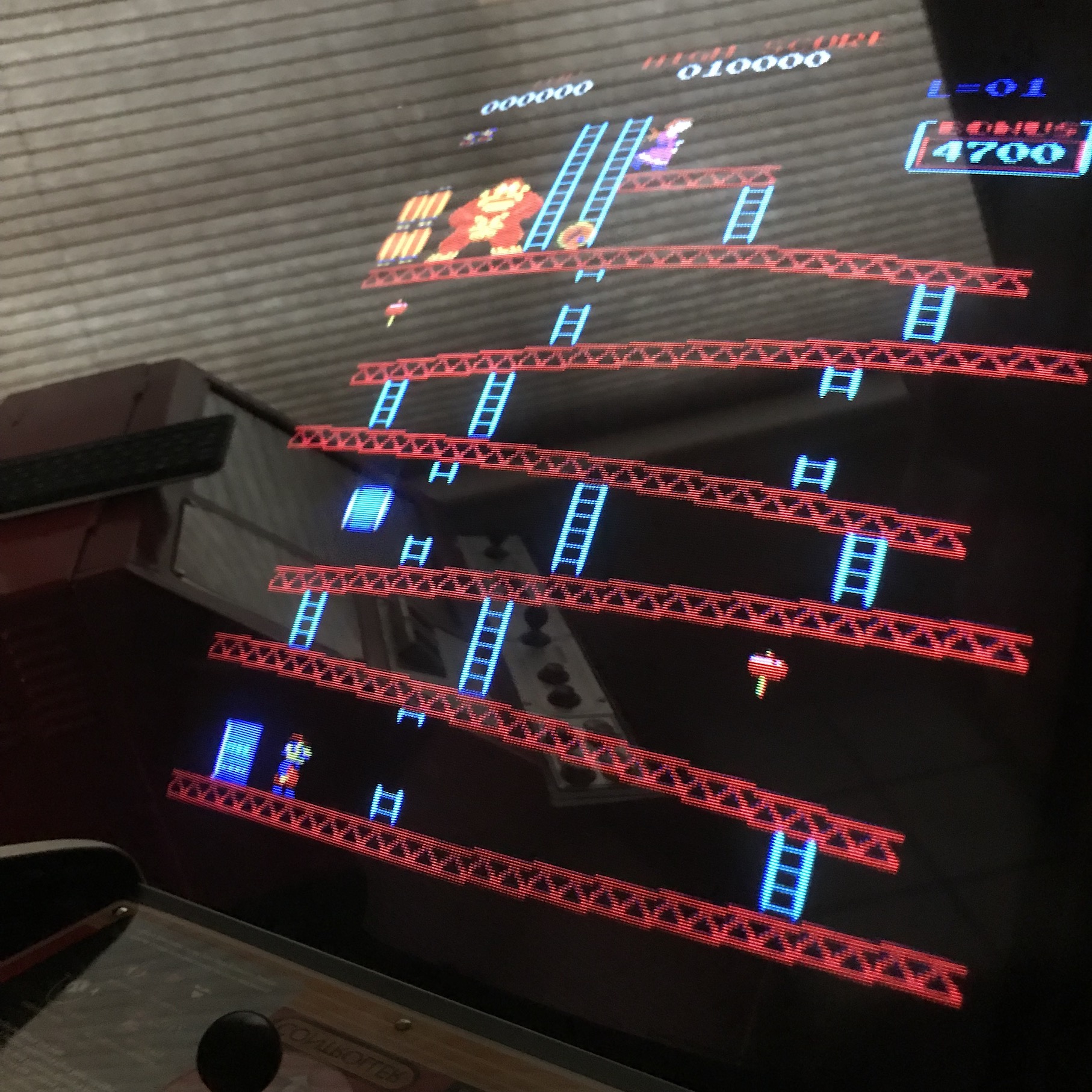

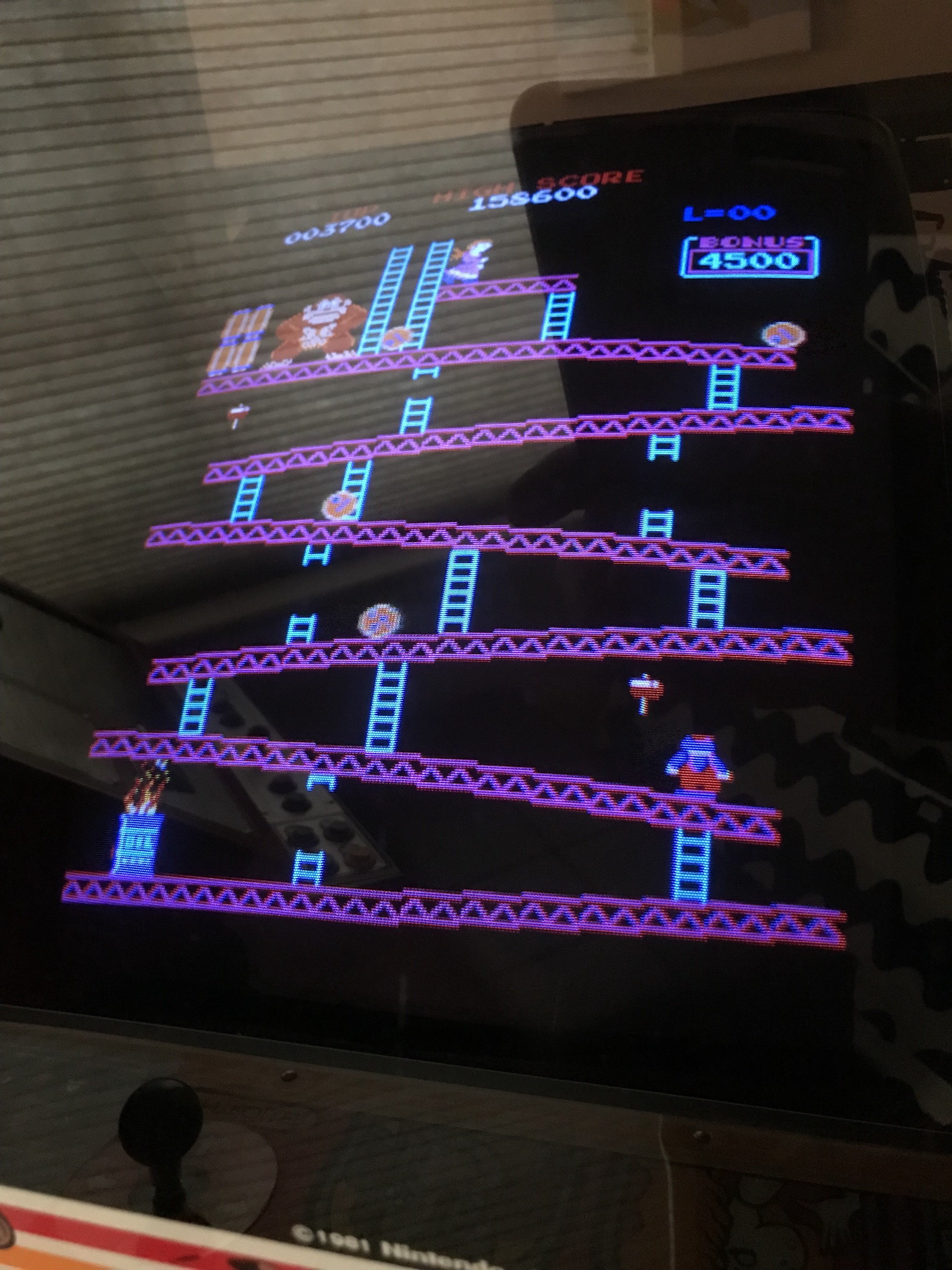

                                          Using Donkey Kong as an example, there are classic arcade games that would historically require sound samples in order to get all of the sound effects or music. These days in Mame, samples are no longer required for Donkey Kong and others. lr-mame2016 is new enough that the sounds are all emulated.
                                          As far as the colors go, here are some pics:
                                          This is FBA. The colors are the same as mame2003.
                                          Here is the actual PCB. I would show how close mame2016 is, but It can't be compiled on Stretch yet, but it is so close I can't tell the difference.
                                          Sorry for the glare! I know most people don't care as much for the 80's verticals and are more interested in the 90's horizontals.
