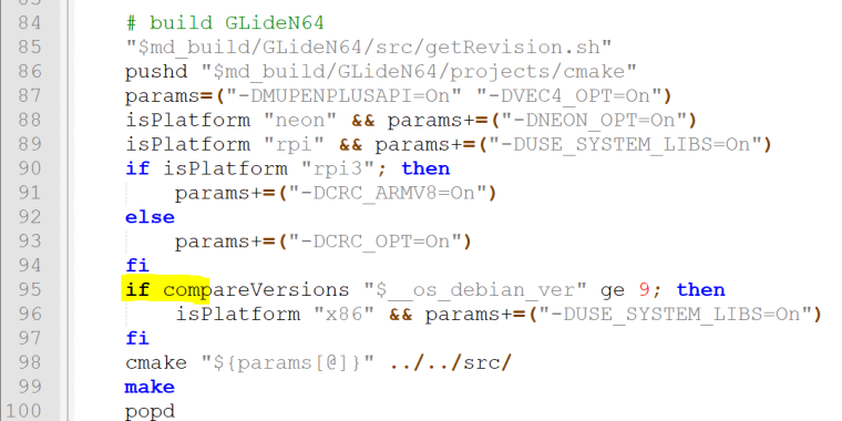

                              mitu Global Moderator @BuZz
                              @buzz I think this can be fixed by adding
                               if compareVersions "$__os_debian_ver" ge 9; then
                              	     isPlatform "x86" && params+=("-DUSE_SYSTEM_LIBS=On")
                              fi
                              to the GLideN64 plugin build stage.
                              This flag used to be global, but was changed in https://github.com/RetroPie/RetroPie-Setup/commit/336f1398c7040f39ae057338978a739ffe8a5a60.
                                BuZz administrators @mitu
                                @mitu looks good thanks. I'll try it.
                                  knightofdespair
                                  Tried it out, worked for me! You guys are the best!
                                    BuZz administrators
                                    I actually just made the flag global again - but perhaps your fix is better. However I guess it's not an issue on newer OSs - built ok on my x86_64 machine also.
