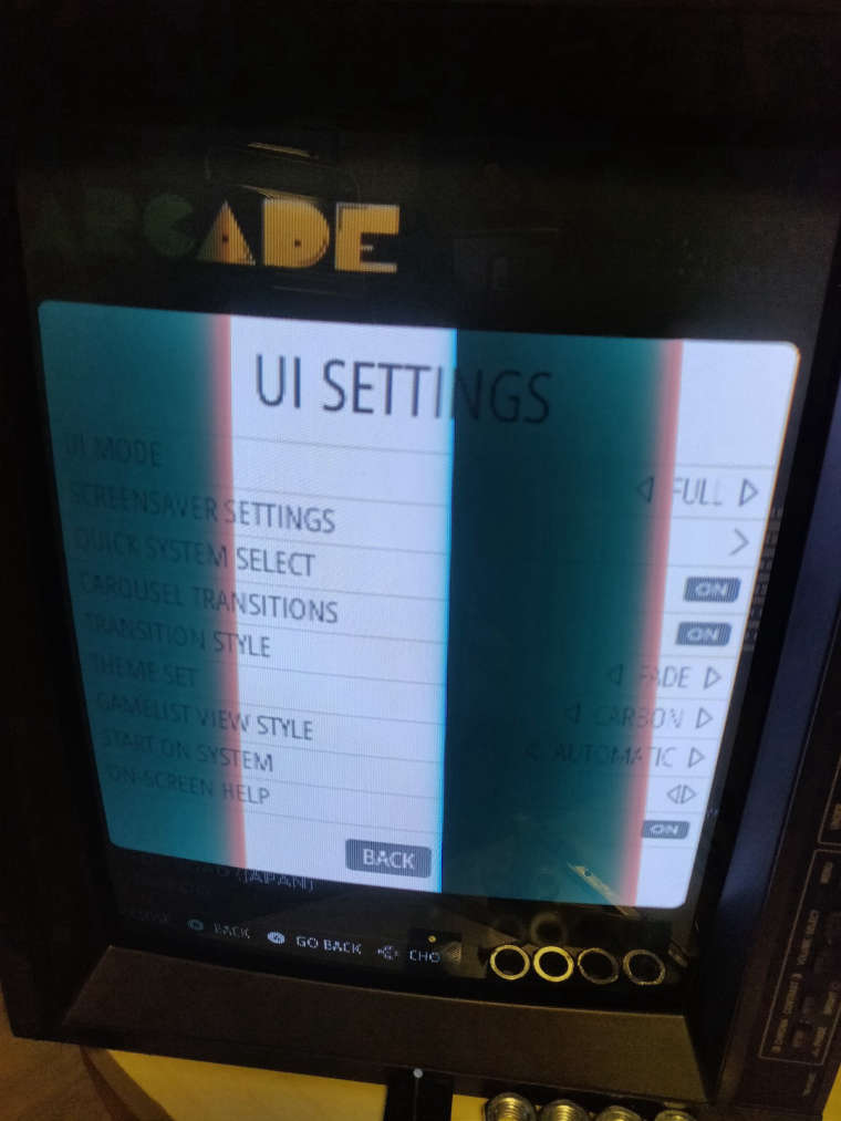

      In ES UI settings menu, when I scroll down & press this "BACK" button, ES quits to "command line" & PI hangs.
      It doesn´t take any keystrokes even from keyboard. Only way pout trough power off. SSH have not tried, if live those cases.

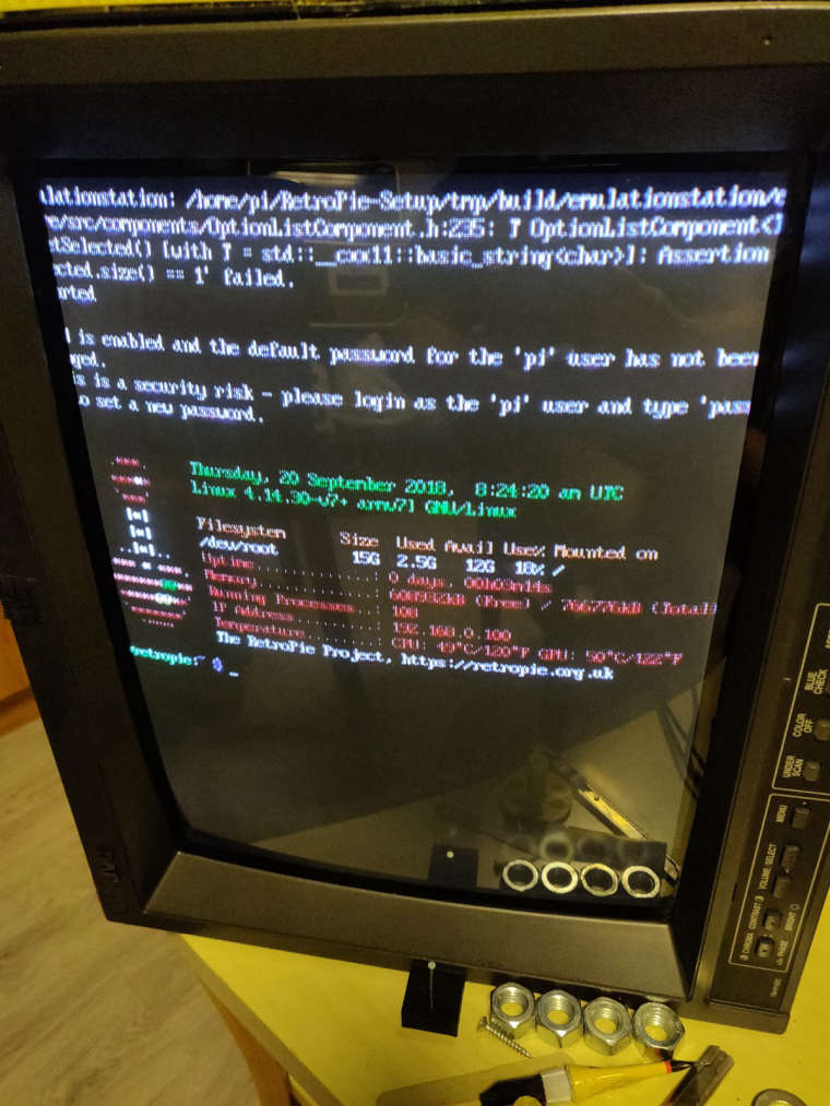

            Here is where I try to exit pushing back & where do I end.
            And as said, keyboard not responding after the malfunction.![alt text](0_1537432201664_IMG_20180920_112357.jpg image url)0_1537432214016_IMG_20180920_112426.jpg

                    On my first picture You can see a command line message "Assertion (something) ==1 FAILED...."
                    I don´t know if this is a clue?
                      mitu Global Moderator @mha
                      @mha said in Pi3 hangs, when exiting ES UI menu:
                      In the configuration file you have
                       <string name="StartupSystem" value="mame-libretro" />
                      but your screenshot of options shows nothing in the Start on System value. Did you had at some point the mame-libretro folder set as starting system, but now that folder is empty ? Try changing the value for the Start on System (clear the value) and see if this fixes the problem.

                        mha @mitu
                        @mitu Right,
                        my roms used to be in Mame & Advmame folders, but changed everything to Arcade one.
                        Will try this!
                          mha @mitu
                          @mitu That was it!
                          Now it works.
                          A big hand to You, Thanks!
