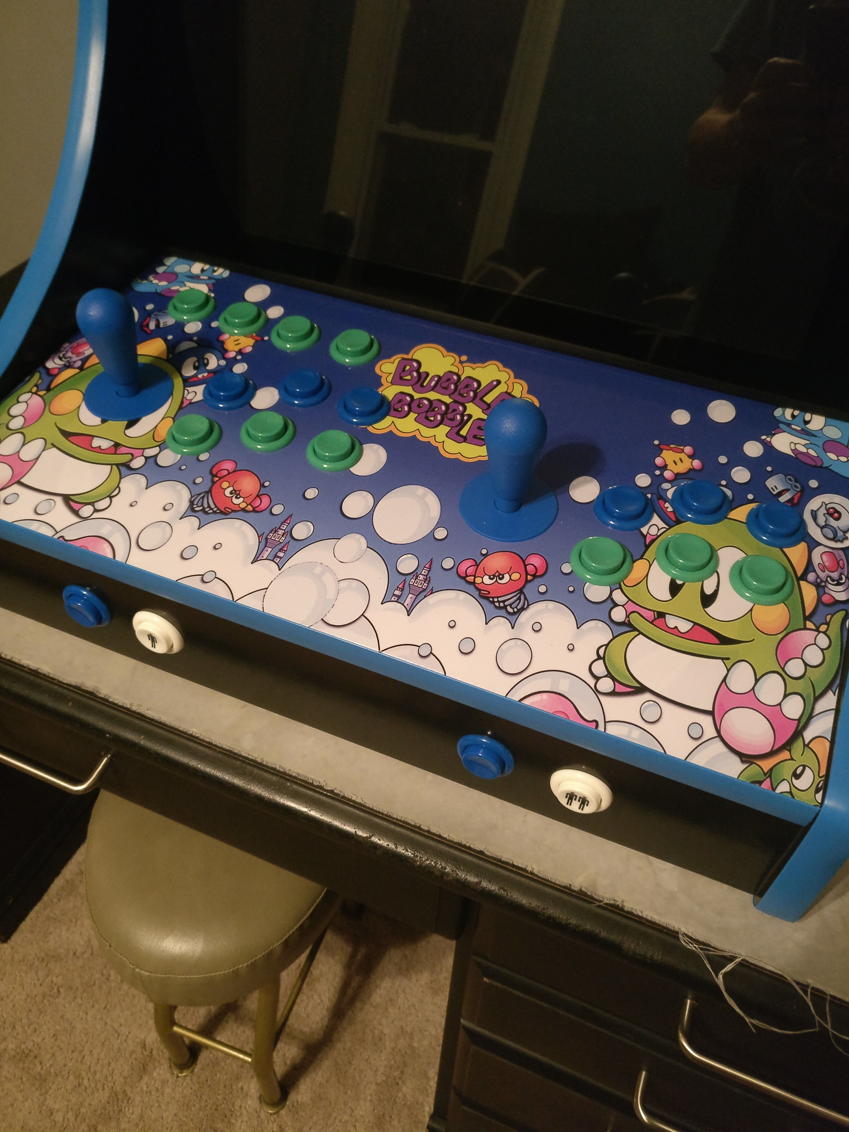

                        I highly recommend splurging for a i-pac when setting up controls. I have a 2 player 6 button joystick setup, 2 start and coin buttons, and 4 misc button (exit emulator, pause, rewind, and config menu).
