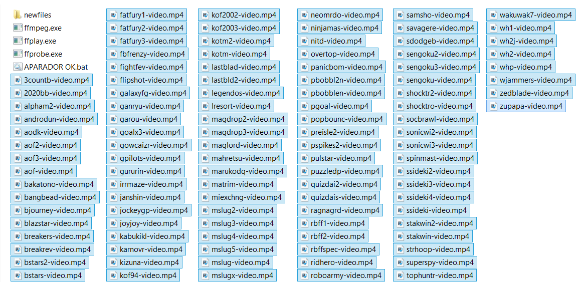

      ILLUSTRATIVE IMAGE SHOWN TO BINDER CONTAINING THE FILES NECESSARY. BEING THE .BAT FILE CAN HAVE ANY NAME
