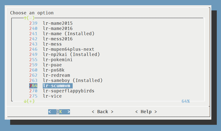

Also I cannot see or find lr-scumm in the retropie experimental page to re install?

Seeing I uninstalled lr-scummvm prior this I am unable to re install it from experimental packages? I do not see it? I am on 4.4.15 How do I install lrscummvm?
@Colossal It's still in the
experimental
section, maybe you need to scroll down a bit ? -
Nope I don't see it in 4.4.15? Anyway olive opened another thread as it doesn't refer to the subject.
