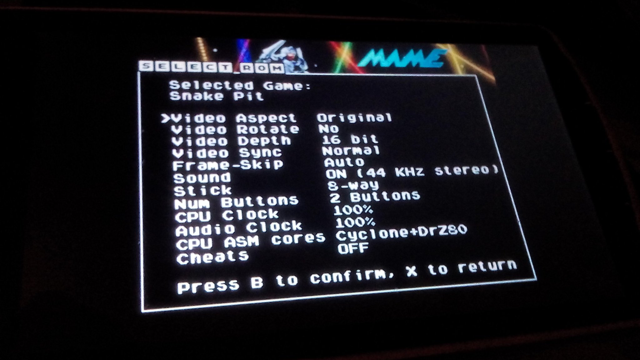

      So, back in the day I used MAME4All on the GP2X, and it had an excellent per-game configuration screen. Screen aspect, mono-stereo, sound rate, rotation, whether to use C or ASM cores, all of that. VERY useful.
      Now, MAME4All on the Pi still has the same UI when launched from the command line, but I've found no way to access that per-game config screen before the game is launched. Is it still there?

          No, not the service menu. I'm also keen on using the non-LR version as it definitely seems faster for me (I'm running this on a Pi 1 in preparation for my Zero - it's just easier)
          As seen on my Xperia Play:

            The RPI port probably doesn't have it then.

                  lr-mame4all on retropie uses the cyclone asm core, but not the DRZ80 as it has some compatibility issues, as well as not working on later ARM cpus. mame4all standalone has a built in array containing per game configurations so it can disable the asm cores for certain games. lr-mame4all doesn't have this so it's better to just disable the DRZ80 core.

                      @BuZz Interesting about the Cyclone core in lr. One of my test games is Pacmania which runs noticeably slower / higher frame-skip on lr-MAME4All in comparison with MAME4All standalone.
                      @dankcushions Yeah, that's what I was playing with. But the MAME4All UI seems restricted to game selection & the functions you could already access when running through ES, nothing like the photo I posted above. Sadly.
