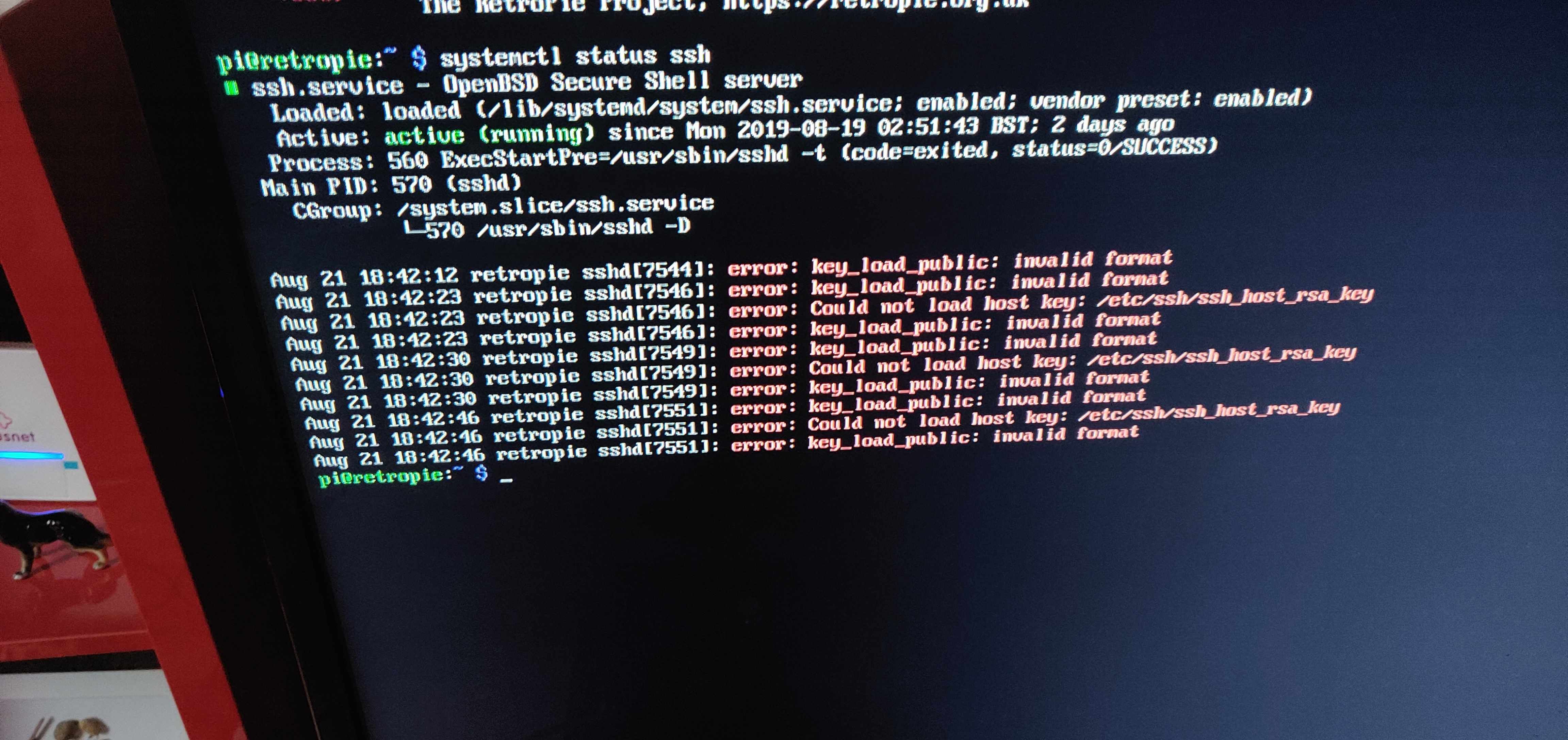

              Jste84 @mitu
              @mitu I've done this and I'm getting this message back
              I'm guessing the bit underneath isn't what you'd expect to see?
                Jste84 @Jste84

                  Jste84 @Jste84
                  @Jste84 said in Ssh help/background music:
                  Wish I knew what was causing this. If anyone can help it would be much appreciated
                  Still struggling with this If anyone can help, would be appreciated.
                    Clyde
                    Are there any error messages from ssh in putty or from WinSCP?
                    You also could give us the output from ssh with the -v option. For example ssh -v pi@retropie or whatever username and hostname your Retropie is accessed by in the network. With -v, ssh gives much more information that may point in the right direction. If you want, you may anonymize the output to some extend, as long as it remains original enough for debugging.
                      Jste84 @Clyde
                      This is the output of the file you mentioned. Any idea what this means?

                          Try re-generating the sshd server keys - maybe the errors shown in the log have something to do with the connection not working - https://www.cyberciti.biz/faq/howto-regenerate-openssh-host-keys/.
                            Clyde @Jste84
                            It says that (some of) your ssh host keys on the Pi couldn't be read, which could be fixed by the method that @mitu linked to. Maybe that will solve your problem.
