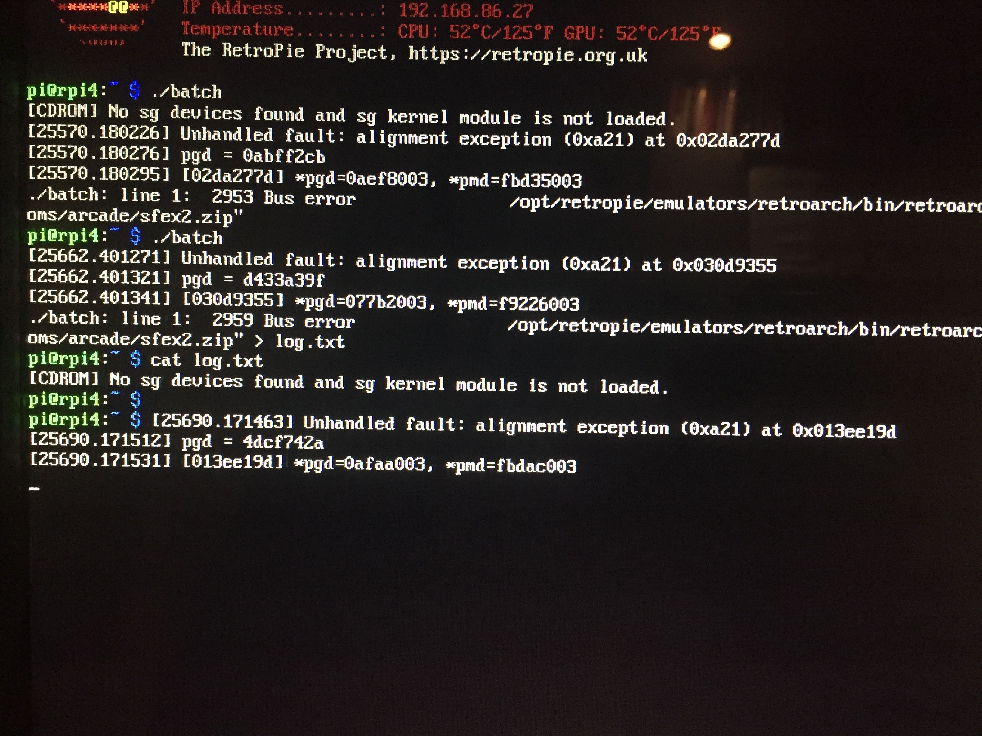

                                @grant2258 Yes. Removed the cfg folder.
                                /opt/retropie/supplementary/runcommand/runcommand.sh: line 1255: 2693 Bus error /opt/retropie/emulators/retroarch/bin/retroarch -L /opt/retropie/libretrocores/lr-mame2010-controls/mame2010_libretro.so --config /opt/retropie/configs/arcade/retroarch.cfg "/home/pi/RetroPie/roms/arcade/sfex2.zip" --appendconfig /dev/shm/retroarch.cfg
                                Pi3B works fine.

                                  @pjft said in Pi4 MAME2010 crashing on Tab menu > Inputs:
                                  just a quick question can you close emulationstation and run this command
                                  do you get any output from this?

                                    @grant2258 said in Pi4 MAME2010 crashing on Tab menu > Inputs:
                                    I do - I get the following more:
                                    Unhandled fault: alignment exception (0xa21) at <memory address>
                                    --- which I just noticed is exactly what the other user reported on their GitHub, but since I hadn't caught that message so far I didn't connect the dots.
