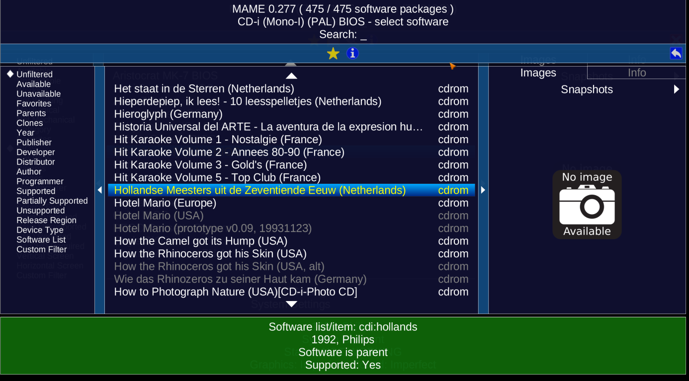

      profiteer @Folly
      This is what I see in MAME. The CD-i (Mono-I)(PAL) BIOS is the only BIOS that exists in the BIOS menu from the left sidebar and while I see the PAL and US version of Hotel Mario, the PAL version is the one that's white and the US version is grayed out.
      F 2 Replies Last reply Reply Quote 0
      • F
        Folly @profiteer
        @profiteer
        Just checked my database :
        Driver cdibios (CD-i (Mono-I) (PAL) BIOS): @arcade@bios@screenless@system@
        Driver cdimono1 (CD-i (Mono-I) (PAL)): @game_console@good@home_videogame@non-arcade@
        Driver cdimono2 (CD-i (Mono-II) (NTSC)): @game_console@home_videogame@non-arcade@
        cdimono1 is the only "good" driver in mame.
        The data for these drivers is extracted with -listxml, for cdimono2 we can check the status :
        /opt/retropie/emulators/mame/mame -listxml cdimono2|grep emulation=
              	<driver status="preliminary" emulation="preliminary" savestate="unsupported"/>
        That is probably the reason why it's gray.
        Although it's preliminary we are able to try to see if it works but I would start with "Hotel Mario (Europe)" on cdimono1 for starters.
        I added a patch when cdimono1 is installed from my script so mouse and/or joystick will work better.
