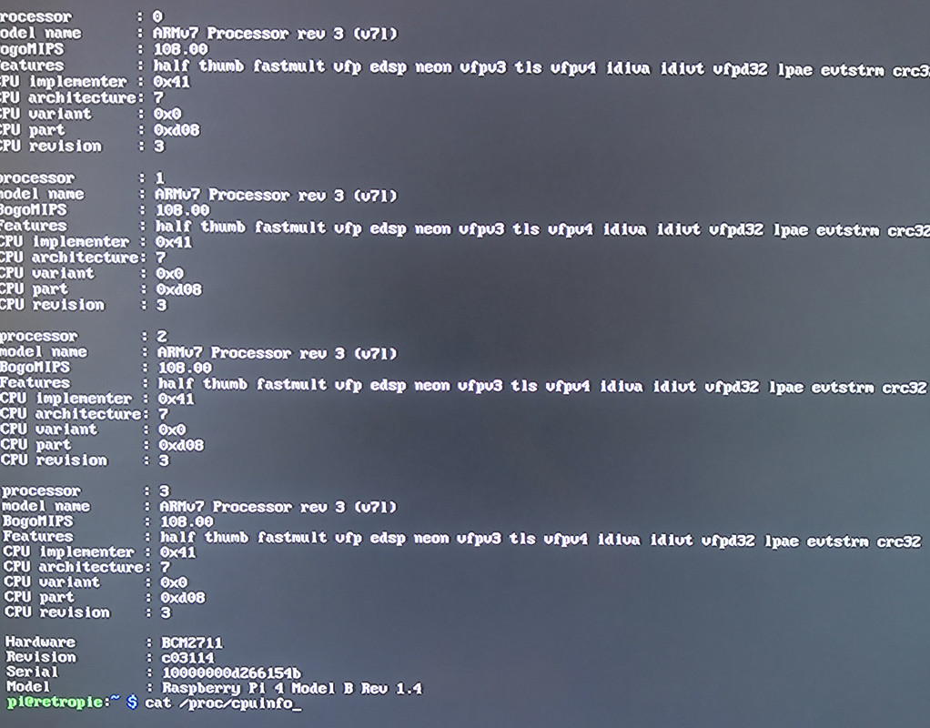

      loopsheloop @mitu
      @mitu said in Bluetooth RetroPie Setup Script Issues:
      What Pi4 model do you have ? Can you run cat /proc/cpuinfo and post the output ?
      It's the Pi 4 B. Results look pretty similar to the one previously posted:
      2 lines that the console remembers isn't the worst workaround I've ever dealt with :) Thanks for looking at this!
        @loopsheloop said in Bluetooth RetroPie Setup Script Issues:
        It's the Pi 4 B.
        Just wanted to confirm this is a 1.4 model (last line) - thank you. Looks like it's not an issue with older models (as @pscotto1234 also noticed), I'm wondering what's different in 1.4 vs older models during the Bluetooth start-up that requiring a restart of the bluetooth service necessary.
        I have one of the older models (1.1) and can't seem to replicate this either with my current install or with a fresh one.
