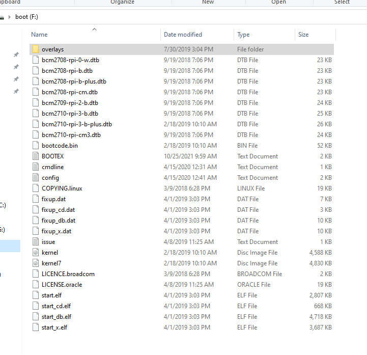

                                      @sleve_mcdichael To my knowledge, the only way to access the BIOS, ROMS, and CONFIG folders is to access them via SSH using wifi (which was the initial issue and reason for this thread). Are you saying that this can be done (access and backup the BIOS, ROMS, and CONFIG folders ) by inserting the sd card directly into the computer? Because I've tried that and all I see are a bunch of folders I don't get the neat and clean BIOS ROMS CONFIGS SPLASHSCREENS, that i see everywhere on other tutorials.
                                      90sgamer9 1 Reply Last reply Reply Quote 0

                                        Okay so you've backed up the SD card and the .img file of the SD card is saved somewhere on your PC. Download and install 7zip to your PC. Use 7zip to open and view the contents of the .img file.
                                        Extract the /home/pi/RetroPie/roms folder and save it somewhere (you can just drag it out of the 7zip window and alt-tab into whatever file folder on the PC you want to drop it into.)
                                        Extract /home/pi/RetroPie/BIOS.
                                        Extract /opt/retropie/configs.
                                        Wipe your card (this is safe, since it's backed up.) Write the new OS to the card in the same manner you did the first time. Set up your locale settings and keyboard layout.
                                        Set up your WiFi. As soon as it's on your WiFi, you can get on the network share and drop the extracted folders right there where it says "roms," "configs," and "bios."
                                        90sgamer9 2 Replies Last reply Reply Quote 1

                                          90sgamer @90sgamer
                                          @90sgamer what i see is this...
