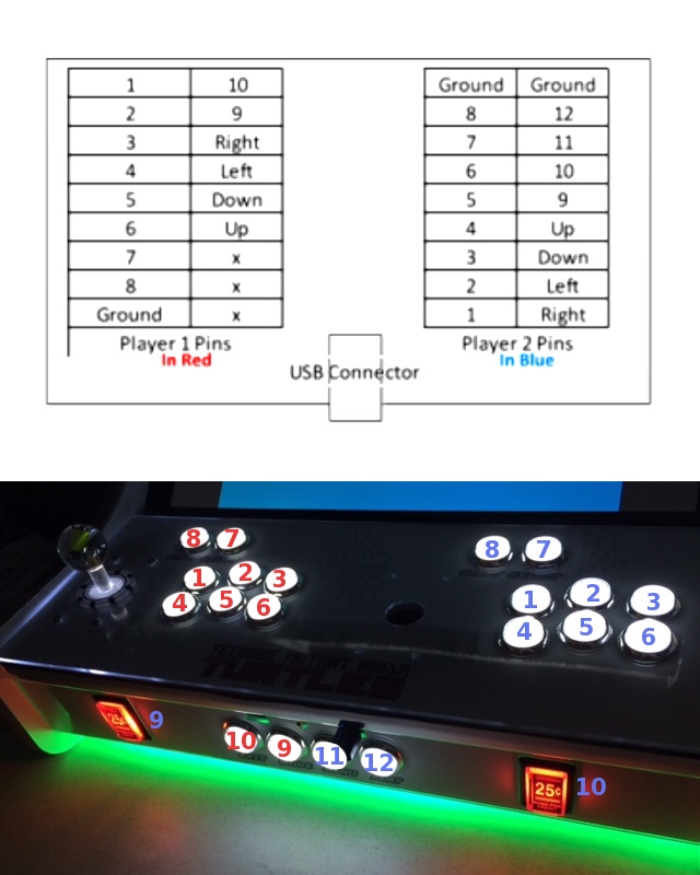

          Hey. So I mapped the configs above and I don't think it is working correctly because the inputs don't distinguish between which player the "9" and "8" belong too. Do I need to add player 1 or something in the input commands?
          • dankcushionsD
            dankcushions Global Moderator @BrockBoyts
            @BrockBoyts only player 1 controls hotkeys.
            BrockBoytsB 2 Replies Last reply Reply Quote 0
            • BrockBoytsB
              BrockBoyts @dankcushions
              @dankcushions
              Hey. I still am having a hard time getting the hotkeys to work. When I copy and past the inputs into the all/retroarch.cfg file (line 490) it moves the coin inputs to the left two white navigation buttons and the current coin buttons become disabled. The rest of the navigational buttons don't work either. I will just keep trying to figure this out.
              I noticed there are two retroarch.cfg files. Which should I use?
              file1:
              /opt/retropie/emulators/retroarch/retroarch.cfg
              file2:
              /opt/retropie/configs/all/retroarch.cfg
              • BrockBoytsB
                @dankcushions
                Would it be better to configure the hotkeys in the auto generated confi for the Xin-Mo joypad instead of hardcoding it in all/retroarch.cfg?
                • dankcushionsD
                  /all/ as far as I know.
                  could you paste the contents of it?
                  • BrockBoytsB
                    @dankcushions
                    Ok. So I was able to get the "mode" and "exit" buttons working out of my four white navigation buttons. In the all/config file there was a lint of text that said "enable_hotkey_btn = alt". Removing it's hashtag caused the hotkey to work.
                    How do I get the "menu" and "play" buttons to work if they are connected to player 2 on the xin mo. They worked with GameRoomSolutions custom configs. Was it their custom es_input.cfg that made that work?

                          input_enable_hotkey_btn = alt
                          input_enable_hotkey_btn = 9
                          what's going on here? you have 2 btns set to hotkey (alt isn't a joystick btn so that will confuse the hell of it - remove this line). i presume you only want the latter set.

                            Thank you. I made that change and the hotkey and exit emulator is working now. I still need to find a way to make Player2_btn 11 (jstest 10) and player2_btn 12 (jstest 11) function as navigation buttons. The Play button (11) should launch games and the menu button (11) should pull up menus.
                            When I did the GameRoomSolutions config guide all the navigation buttons worked but the coins did not. Now that I have it setup right with the coins working I want to get the navigation buttons working. Like I said the left two are working now because they are player 1 buttons.

                                  @BrockBoyts
                                  How did you assigned player 2 buttons 11 and 12?
