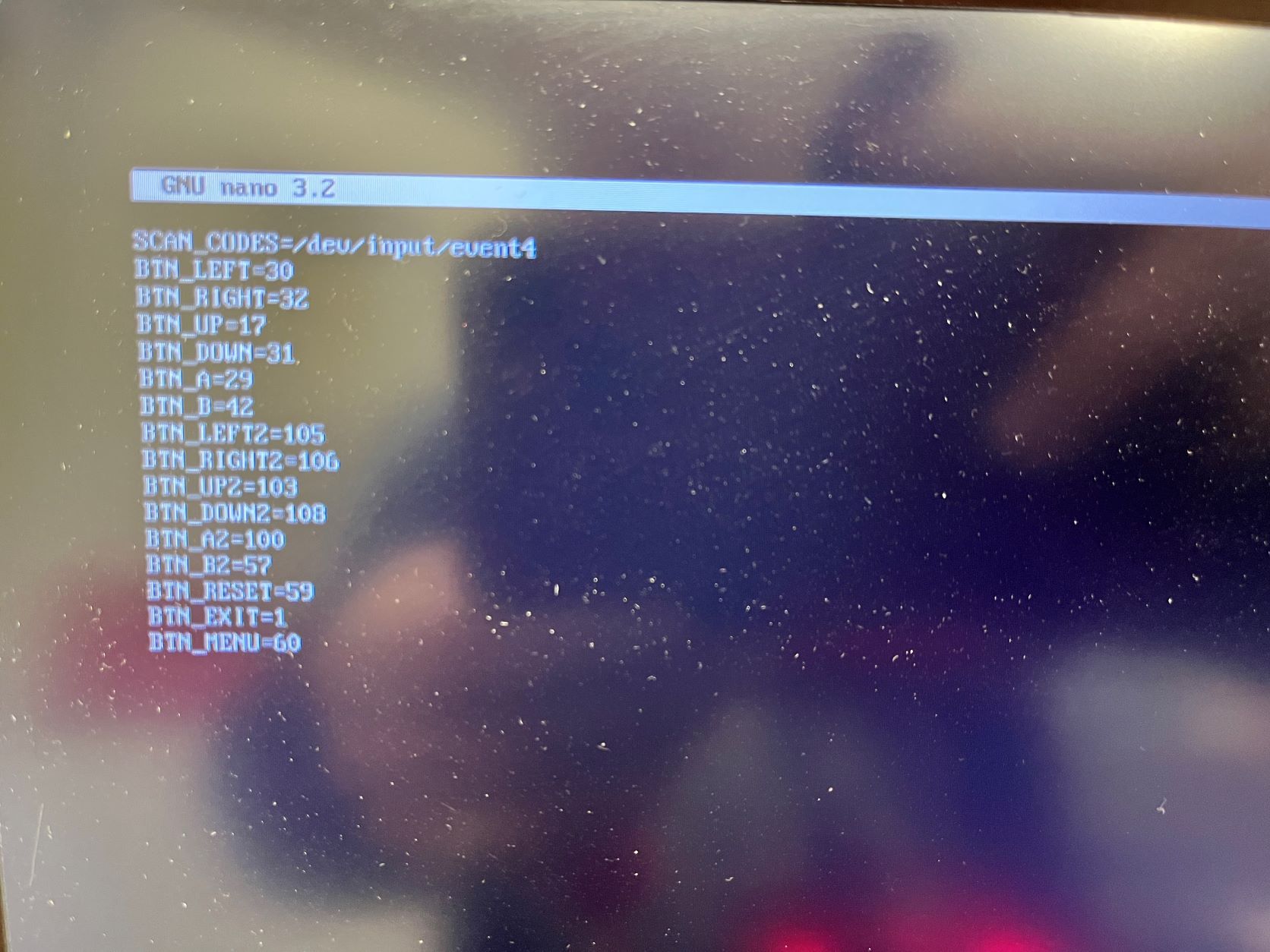

              @mitu ! I think I've found it, but I'm not sure which numbers it is?
              I tried evtest /dev/input/event1b but nothing occurs.
              My other idea was maybe the permissions to the makecode games weren't on? I can't find a way to see if it's on or off though.

                  lrigbyDL @mitu
                  @mitu Ok I think I had a successful evtest - it was running really fast but I managed to see value 90001 etc. I managed to get a picture of it: IMG_5544.jpg
                  How do I go about customizing the mapping?
                  I have found the code (I think?) in the /sd.
                    Hm, the 90001 values is from an EV_MSC input, which is a button or joystick input, I don't think it needs to be mapped.
                    According to this issue, the "EG Starts Arcade" kit should be supported automatically. There's even a .cfg file posted there.
                    Maybe the launcher is trying to configure your keyboard instead of the controller ? Have you tried starting a MakeArcade game with only the controller kit connected ?
                    If that doesn't work, you may try open an issue on @Vegz78's repo, I unfortunately have no experience with the MakeArcade setup - I just know they've been working to make this work as seamless as possible in RetroPie and other gaming oriented projects (Recalbox and Batocera).
