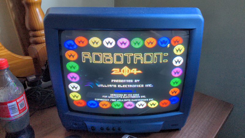

      Hello all
      Just got myself a Pi 3 B because i found a old CRT TV in a skip. The CRT is in really good shape and despite being one of the more budget TV's it does have a really really bright clear picture and I'm only using composite so far.

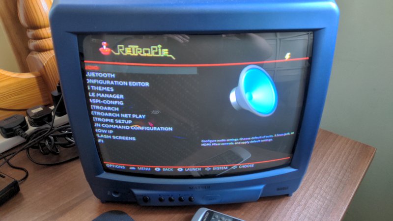

      Firstly, the menu and some emulators are not sitting correctly on screen. I have looked online but not seen much about how to fix this, is there an easy way to do it or perhaps is there a Retro Pie image/theme for CRT TV's?

        For the first question only, I believe you can fix the screen by adding custom overscan settings, see: https://retropie.org.uk/docs/Overscan/ .
          crinale0 @sugarfree
          Thank you! this has fixed the issue of text being off screen and various emulators too.
          My settings just in case anyone comes across this were:
          disable_overscan=0
          overscan_left=32
          overscan_right=16
          overscan_top=16
          overscan_bottom=16

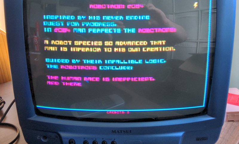

          EDIT: even better results with the following:
          disable_overscan=0
          overscan_left=32
          overscan_right=16
          #overscan_top=16
          #overscan_bottom=16
          I do however seem to have an "pin cushion" issue on the main menu now? Any idea why that is?

            I haven't tested Pi's with a CRT yet, but I have seen something similar when I was running a DVD player with my old Crt TV. Does this affect games?
            Try to change disable_overscan=0 to #disable_overscan=1
              crinale0 @sugarfree

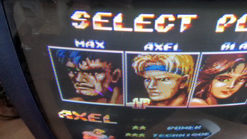

              It does not effect games oddly, no but I simply changed the theme to another one which was better looking in my opinion anyway and its mostly gone now, Games are perfectly centered now which is excellent and the picture looks so good.
