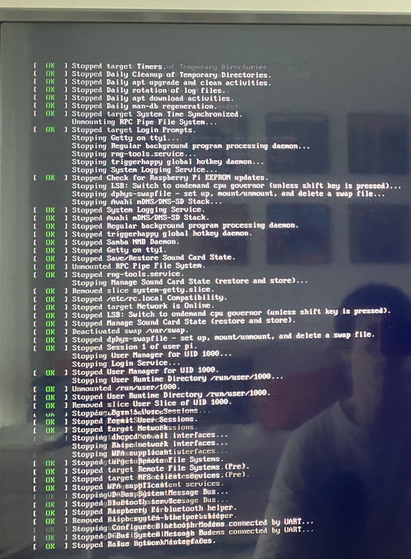

              okay, I just did a clean install of retropie ( the one offered on this site) . I haven’t installed any emulator ,I just detected my blutooth keyboard to see what happens… and voila, again this shut down thing with fn+f12! system :raspberry pi 3 model B + rev 1.3 running on raspbian GNU/linux 10 (buster)
              on the pic you can see what I get when fb+f12 is pressed..
                sebalberico @sebalberico
                  I don't know where is thing coming from - can you try to disable the triggerhappy service ? Run
                  sudo systemctl disable triggerhappy.service
                  and reboot, then try again to see if F12 is having an effect.

                    just to be clear. first i have to go to console (somehow) and then type what you wrote?
                      mitu Global Moderator @sebalberico
                      @sebalberico Yes. You can exit EmulationStation and you're be left at the console with a command prompt.

                        works perfect!! thanks a lot!

                          you know what? due some problems I had to format and re-install all… the thing is , I tried to do the same trick but… this time doesn’t work…this appear on screen (i have to mention that except fn+f12 the reat of the keyboard doesn work when I am on the main retropie menu (you know, where the systems are displayed) BUT when the trick worked, at least i was able to move the menu with the arrow keys…. and of course F4 send me to the console…
                            @sebalberico said in How deactivate the option to shut down with F12 ?!:
                            I had to format and re-install all… the thing is , I tried to do the same trick but… this time doesn’t work…this appear on screen...
                            Then I have no idea what can trigger this reboot signal. What kind of keyboard is it (model/vendor) ?

                              I got it.. as It is a generic chinese Bluetooth foldable keyboard, its beand could be anyone…BUT just pressing keys here and there, apparently there are one key for android,ios and another for windows (you activate this with -again- fn key) activating the windows mode all goes perfect.
