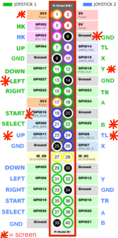

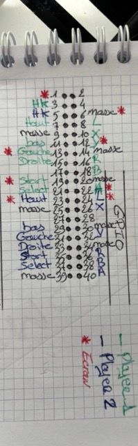

                                    I noticed a small error (I would even say that it is an incisive detail) but I connected the A player 1 button and it is the B player 1 button which is detected, is this normal or a problem coming from my configuration?
                                    LolonoisL 1 Reply Last reply Reply Quote 0
                                      Jimmy14
                                      As I explained above, I'm using a TFT screen connected to GPIO in this configuration.
                                      The problem is that the GPIO connections for Player 1's buttons are identical to four GPIO connections on my screen, and for Player 2, there are two GPIO connections identical to those on the screen. (See diagram above.)

                                        • LolonoisL
                                          Lolonois @Jimmy14
                                          @Jimmy14 said in activer bouton arcade gpio:
                                          That is what we will handle now.
                                          Apologies, if I took the long road, but first I wanted to assure that a simple setup with one joystick works.
                                          So, as the TFT display uses pins from both joysticks and you can not dual-use a GPIO pin for two devices, I see two options:
                                          One will take a little more space, the other takes less space but needs more fiddling in the *.dts files.
                                          Option 1:
                                          Get two MCP23017 (port expander) on a breakout board, they will use I2C (simple but effective wire protocol) instead of one GPIO port per Button/Direction. Daisy-chain them as I outlined on the Arcade DT project site. The MCP will use the I2C ports of the Raspberry Pi (GPIO2 and GPIO3), which are unused by the TFT. Wire the buttons to the MCP and use the configuration in config.txt instead of the gpio-joystick entry:
                                          # two MCP 23017 connected joysticks, the second with: I2C address 0x21, IRQ on GPIO17
                                          dtoverlay=gpio-mcp-joystick,joy1
                                          dtoverlay=gpio-mcp-joystick,joy2,addr=0x21,gpiopin=17
                                          This should work as GPIO4 and GPIO17 are not used by the TFT display.
                                          If you wire/solder some MCP pin to the "wrong" BTN function you can change the MCP ports to the BTN function in this file. However any changes there need a recompile/re-install and re-boot.
                                          Option 2:
                                          Use one Joystick directly on GPIO and one via an MCP23017. I would go only this path if space is a absolute premium in your Arcade build.
                                          It also requires that you only use spare GPIO ports which are neither used by the TFT (thus not GPIO 18,27,10,11,25,8) nor by the MCP23017 (thus not GPIO 2,3,4).
                                          The GPIO ports for Joystick 1 via GPIO should then be entered in
                                          this brcm,pins line, also altered in fragment@3 in the up, down, left, ... sections that each GPIO from fragment@1 (brcm,pins) is used exactly once.
                                          Additionally the Hotkey configuration in fragment@5 and fragment@7 should be adjusted to a spare GPIO (as the currently defined GPIO 2 is needed for I2C and MCP).
                                          Eventually I would remove any even fragment@ (2,4,6,8) entry and anything that relates to joystick2 in gpio-joystick.dts (as joystick 2 will be addressed via MCP).
                                          That said, I guess using two MCP is the easier option.
                                          Hopefully, my answer is not too confusing. If something is not understood please let me know.
