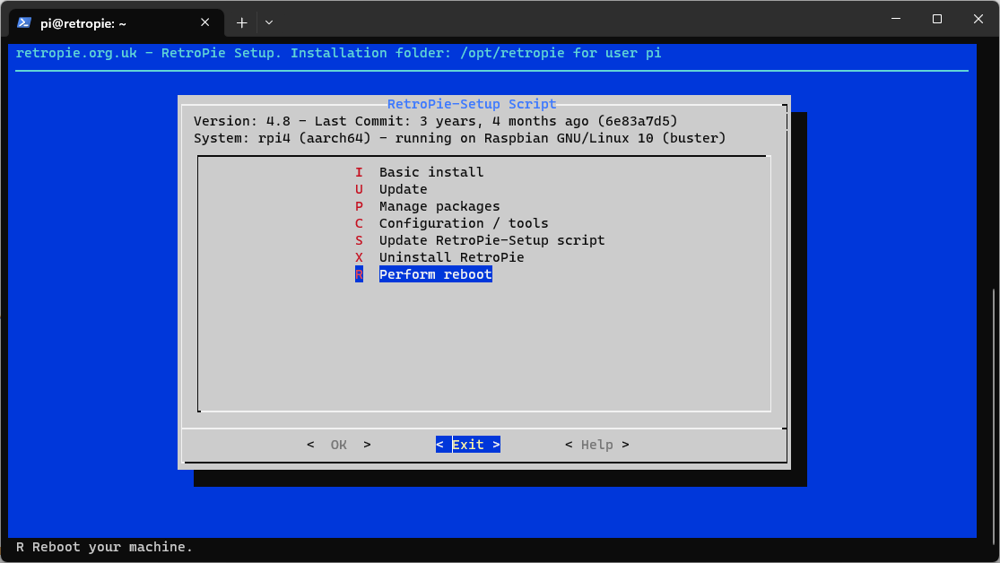

                Your screenshot though shows a 64 bit kernel, which is not included in the RetroPie image - how did you install it ?

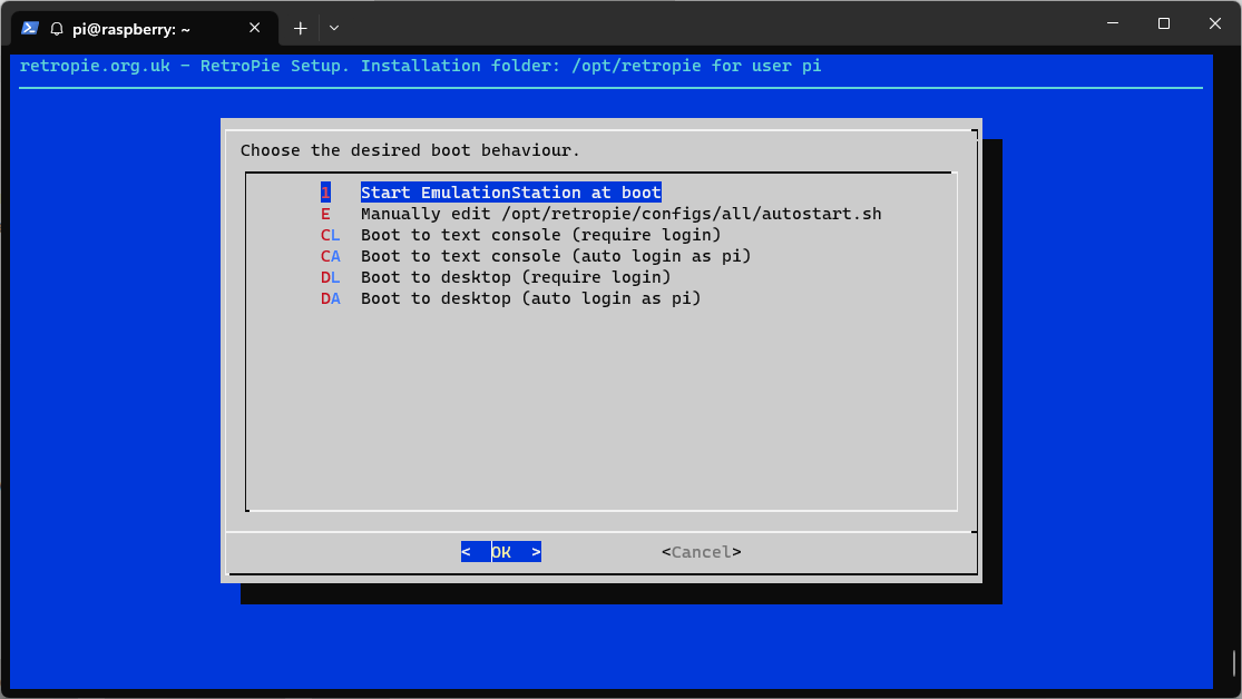

                    @mitu Ive installed raspOS and retropie, but now they dont even run)) After launching I see console and some text (smth like "debian gnu linux raspberry tt2, my ip, raspberry login:"). Do you know what to do with this?
                    I tried to choose emulationstation at the settings, I tried to add line "/usr/bin/emulationstation" in the /home/pi/.bashrc, but its not working...
                    I cant understand how to make autostart for raspOS or for retropie

                      @gilllig said in Retropie doesnt boot with changed config:
                      What exactly does this mean - they're both not running ?
                      You're running in an unsupported configuration, as I mentioned in my previous post, so you should not use the normal RetroPie auto-start options from the menu.
                      If you have installed the RaspiOS with Desktop, then just use the default option to boot to the Desktop. You can start EmulationStation from a terminal by typing emulationstaton. If you wish to automatically start Emulationstation after the boot to desktop is done, then
                      • create the $HOME/.config/autostart folder
                      • add a .desktop file with the command to start the terminal and EmulationStation (lxterminal -e emulationstation).
