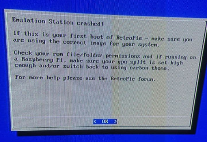

                          By the way sorry to disturb but we are also experiencing another issue : when we launch Retropie after a long break (switch off) retropie Emulation station crashes after just a few seconds for some reason and we get an error message. After launching one more time it doesn't crash anymore and we can play but it does crash every time we launch Emulation Station after we switching off for awhile. Do you know what cause that?
                            This doesn't sound familiar, but please post the exact error message you receive.
                              Skum1988 @mitu
                              @mitu I am using Comicbook maybe that's why
                              This is the error message that I get everytime I switch on my Rapsberry pi 4 (after not using for awhile). When I reboot however I don't get this message anymore and I can play but it's a bit annoying to get this message every time I launch Emulation station
