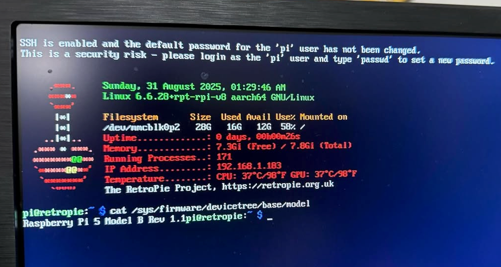

      I just got my first Pi 5 8g Revision 1.1 board and all of a sudden my Dreamcast games no longer load. They just go back to the emulationstation menu. Here's the log:

      Any idea what could be causing this? Everything works fine on my Pi 5 Revision 1.0 board but now things are broken.
      Please help!
      TPRT 1 Reply Last reply Reply Quote 0
      • TPRT
        TPR @TPR
        Looks like sudo apt update && sudo apt full-upgrade did the trick!
