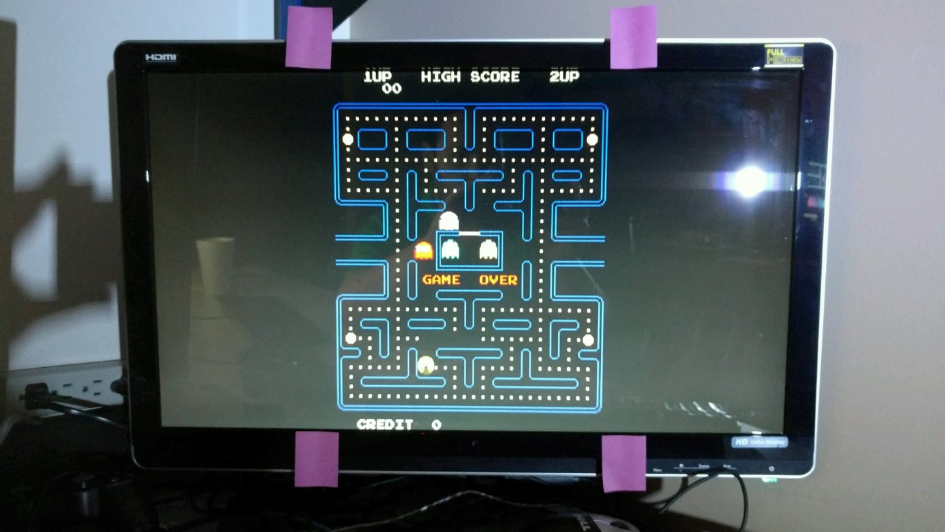

      Yes! You understand the issue. I was in the process of taking pics to show you. I'll post them here anyway in case others who read need a visual reference to understand the issue.
      The pictures are taken of a 16:9 display with pink post-it notes used to mark the original (no CFG file changes) rendered screen area.
      This is with no CFG changes at all:
      This is with the single CFG line: allow_video_rotate = false
      This is with the CFG changes I found via Google that @caver01 and I have discussed:
