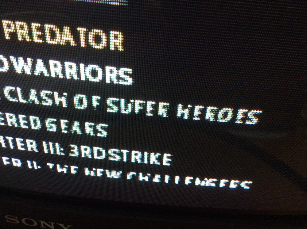

      I got a little problem with nearly every theme on a CRT. The only theme, which displays nearly perfect is "pixel". With a 240p resolution it is not possible to display small fonts, but with the "CRT Centered" theme for example the fonts are big enough, but looks like a little destroyed.
      When i manually edit the theme and make fonts bigger, the problem is the same. :-( Any suggestions?

            I found out the solution for the problem. The font only looks destroyed when a β€ž:β€œ or β€ž-β€œ is in the scraped name.
            When i delete all : or - this game looks good, but others game names looks are the problem. It's so confusing! There must be a solution i have to find.0_1496907722724_IMG_1026.JPG

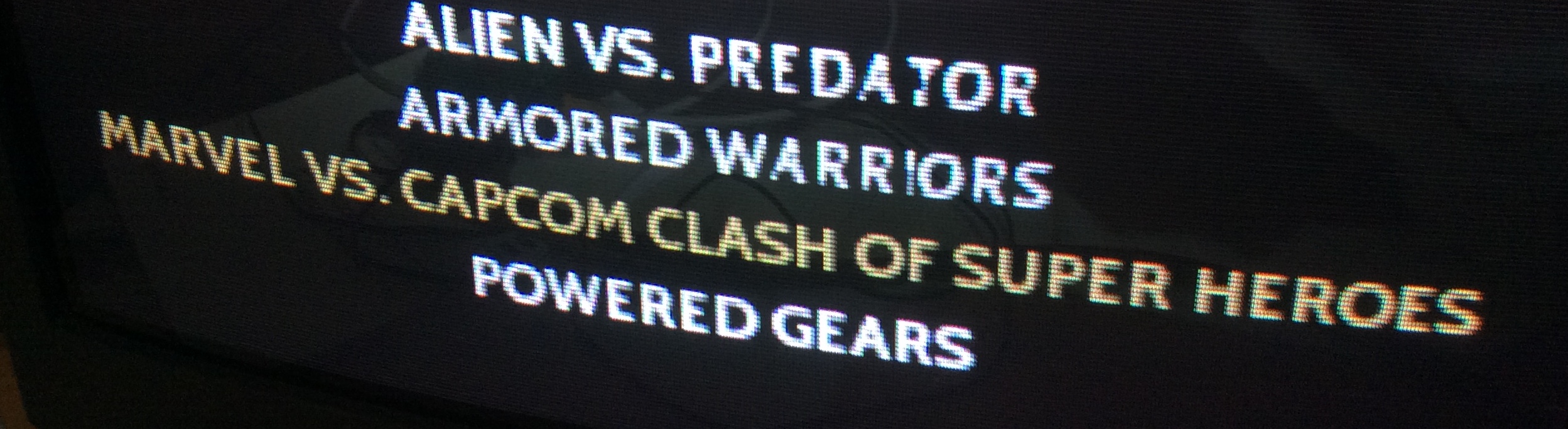

                  @edmaul69 yes... emulationstation is not the best solution, but it's simple and works (mostly). Ich think i have to set the perfect size for the font in relationship to the font itself and size of the gamelist. now i got a perfect size at <fontSize>0.0483333333333333</fontSize> :-D but with another theme. If i set the same size and use the same .ttf in other themes it's ugly as before. So i use my simple customized theme until there is a better solution.
                  • funkybunchF
                    funkybunch
                    https://github.com/anthonycaccese/es-theme-crt-tft this one works well. The Video does not fit cause of the z-index, but i think there will be a solution soon :)
