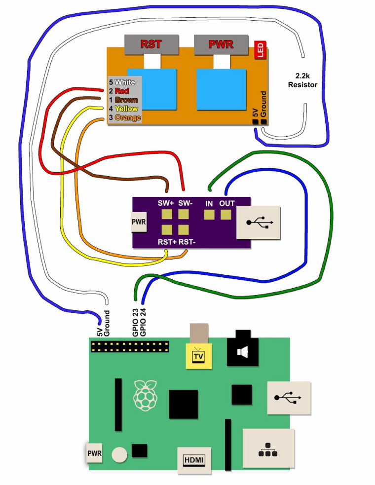

            @Newellj79 I used the gamecon's controller driver schematic which also powers the led on my sfc. I'm not sure if it also powers the nes led. If it doesn't, I've seen people add a resistor and power it via gpio. Take a look at some other people's works. I found this one: 0_1499460602754_1473747654108-piwiring.jpg
              If you're using a Mausberry, they have a really clear diagram on their setup page.
