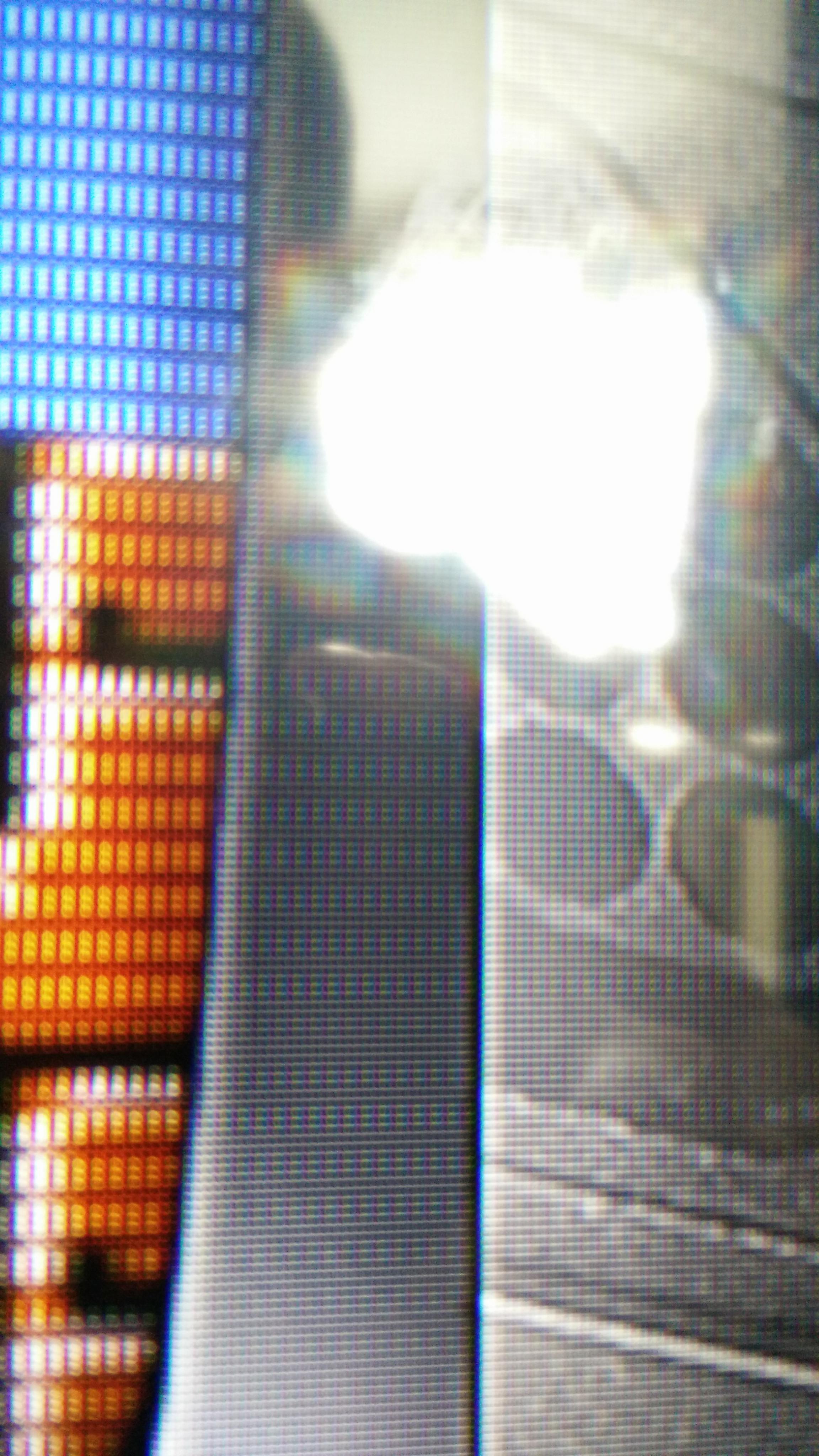

      I was trying to add a CRT effect to these bezels:
      I'm happy with the effect I was able to get, however I noticed an issue. I's difficult to get a good picture, it's much easier to see in person but the CRT effect seems to appear on top of the bezels:
      I've been using photoshop for years, it's not a layer issue; I didn't put the CRT effect layer on top of the bezel. I can't see anything wrong with my image. In fact, if I reset the game and take a picture while the screen is black, you can see that there is no CRT effect on the bezel:
      I'm at a loss here, I can't understand what would be causing this. Does anyone have any idea what might be causing this issue?
        edmaul69 @dover19
        @dover19 did you ever make a scanline only overlay while testing? Im not sure if you can display 2 overlays at the same time but just thought i would ask.

          double check the layer opacity/blend modes in photoshop, and make sure the overlay opacity is set to 1.0 in the retroarch settings.

                    dover19 @chipsnblip
                    Alright, so I double checked photoshop and both layers are at 100% opacity with a Normal blend mode @edmaul69. The opacity is definitly set to 1.0 in the retroarch settings and yes, I do have a viewport set to the size of the transparent area of the overlay @AndrewH:

                    @edmaul69, I'll try using two overlays but I have a feeling I'll either get none or it'll display only the first one that appears in the cfg file.
