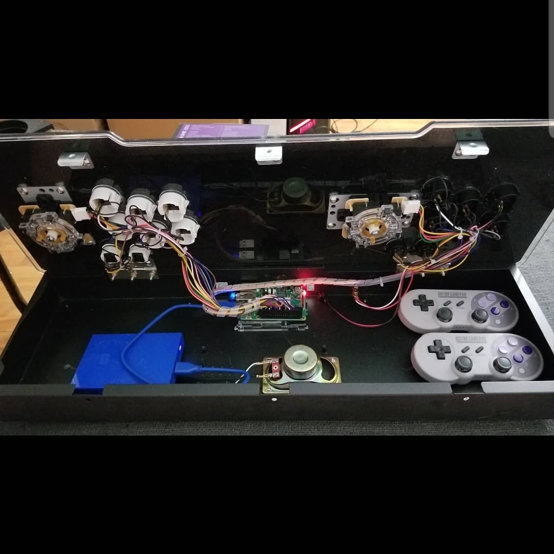

      With the latest update 4.1.17 on jessie and stretch, i'm having an issue with one of those blue ps1 to usb adapters plugged into my pistation i built. its plugged into port 4 so any other controller plug in should take priority. But every time, it over rides and is always takes over as player 1 and 2 and the other controller is always player 3. even any bluetooth controller that used to always be the highest priority, is now remapped to player 3. was there a change to retroarch or the usb port priority? has anyone else had an issue liked this.
