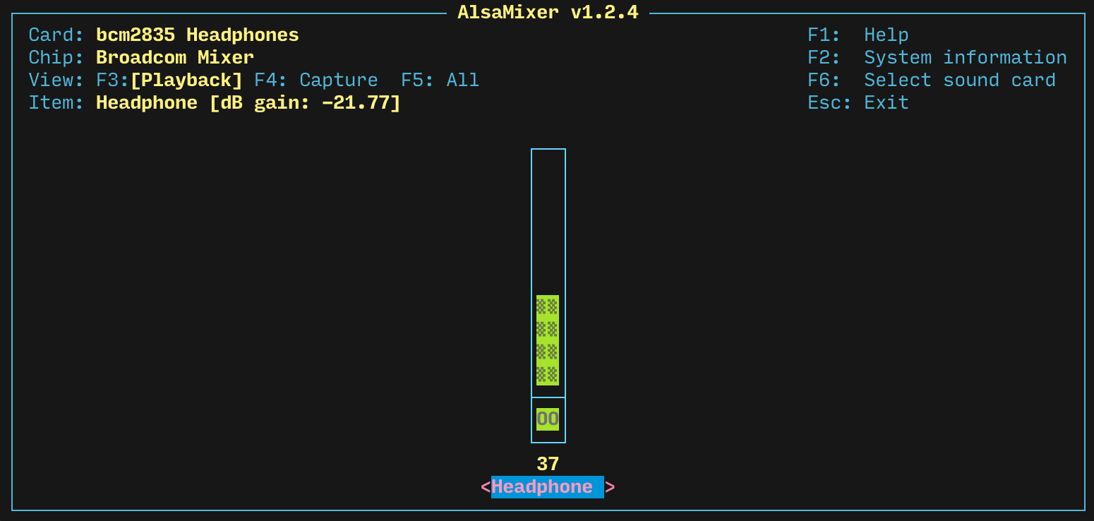

            No, you should just type alsamixer and note the mixer's name (4th row on the top left menu). For instance, in the screenshot below the mixer is named Headphone.
            6e169b26-75f2-459a-8dc8-8f15484be18f-image.png.
            However, based on the error you're receiving (cannot open mixer) it looks like the device has no hardware volume control (mixer). You may be able to add a software volume control, following the instructions from this page.
