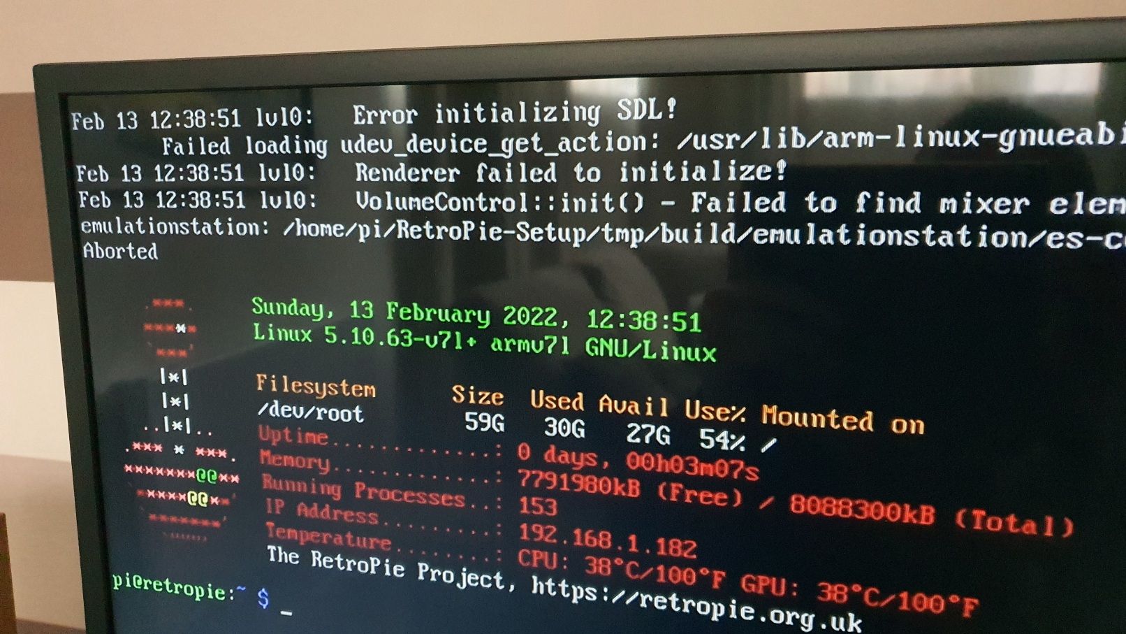

              @mitu The thing is Aleph One worked perfectly then for no reason after restarting it went all laggy and glitchy. I decided to test it it on a different retropie installation on another sd card, put that in my rp4 and it works fine no issues and has the same boot config as this one. I am just at a loss what is causing this issue on my main install. Does anyone know all the locations of where adeph one puts configuration files so I can clean the whole thing off the system. When uninstalling it still leaves stuff in retropie/ports and opt/retropie/config/all/ports folder which I have deleted. It is so I can do a full clean install for aleph one as from the error log there seems to be problem with the config file.
                stephenuk
                OK interestingly dukenukem 3d has a black screen now just with sound, maybe the graphics driver is corrupt, retroarch based emulation is fine, it just seems to be affecting ports, is there anyway to fix this without a fresh reinstall? got this error when launching cannonbll but restarted and it worked again also says void font:rendertextcache !20220213_124006.jpg

                        In regards to Alephone - Sorry - there looks to be an issue with the new SDL2 we updated to and some software. I am looking into it.

                            @buzz Hi Buzz ah ok, tho it is very strange as it worked perfectly then stopped later in the day unless there was an update that has conflicted. On my second sd retropie install it works fine, but not done any updates on that.
                              BuZz administrators @stephenuk
                              @stephenuk I have rolled back to the older SDL2 version until we can sort the issue. If you go to RetroPie-Setup, and choose Update RetroPie-Setup script,
                              then go to Manage Packages -> depends -> sdl2
                              and choose Re-install (from binary)
                              Then retry the software you had issues with.
                                stephenuk @BuZz
                                @buzz Thanks buzz you are a star, dukenukem and Marathon working again, I was going crazy thinking jeeze what have I done to my raspberry pi. Massive thanks again
