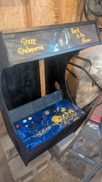

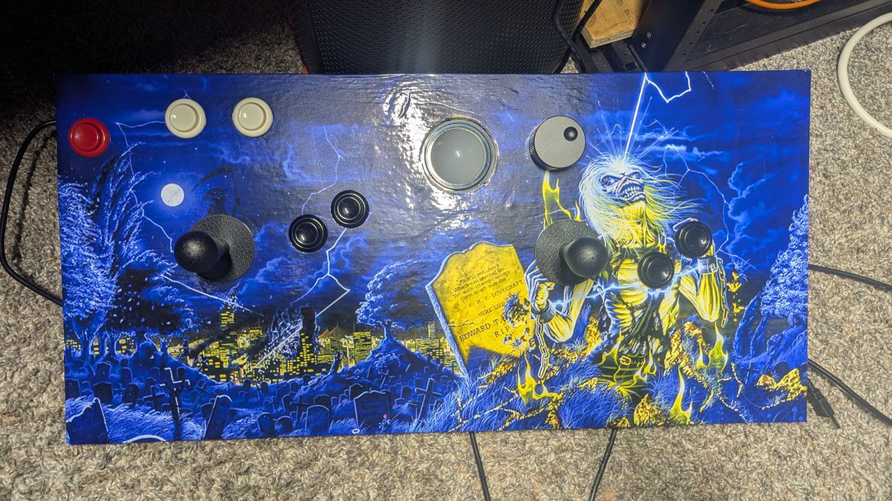

      PXL_20250704_154601434.MP.jpg Greetings gamers! I moved my retropie system into a new custom built cabinet. In the new cabinet I needed to construct a new control panel and this is where I ran into problems. I think I wired my 2 DragonRise USB encoders backwards. I thought ah, no big deal Ill just remap everything. WRONG!
      I have been wrestling for 3 days with this and I am shaking my finger at the USB encoder and that maybe I damaged it or shorted it out mounting it to the bottom of the panel..... In a nutshell I will layout my control panel.
      It is a 2 player system. Very basic. It is the EGStarts kit you see on Amazon https://www.amazon.com/dp/B06XV7H7RB?ref=ppx_yo2ov_dt_b_fed_asin_title
      I have on player one side a (red) hotkey button and 2 (white) buttons for select and start (similar to NES systems) I only want to emulate NES and Atari 2600 games. then I have 2 (black) buttons) for Button A and Button B (Like NES)
      Player 2 only has a joystick and an A and B button only.
      When I start (super mario brothers for example) the game loads (shows both controllers and tells me which emulator the rom is using) but select and start buttons do nothing. Button A for either player one or player 2 will start the game but when the game starts it is player 2 that is running.
      After day 3 of verifying config files and jstest functions I am wanting to just buy new encoders. I think half the problem is these DragonRise Encoders are not getting distinguished properly and I am frustrated beyond belief (this used to work in the old cabinet)

        The most common issue for dual player arcade controllers is that the players' buttons are not wired identically, i.s. P1 button A doesn't produce the same input code as P2 button A.
        Due to the fact that both players/gamepads have the same model name, the same gamepad configuration applies to both - so the configuration produced when configuring P1 applies to P2 (and vice-versa). If your player buttons are not wired identically and some buttons are 'de-synched', then you - always - get a wrong mapping for one of the players.
        Check with jstest that - for each player - the same button (A/B/start etc.) proces the sam input coded.
        Also, please don't post ChatGPT output - it's mostly garbage and and it doesn't help at all.

          @mitu thanks for responding. I guess my only reason for populating the summary from gpt was to show what I have tried, there is nothing in that data that says "you should do this" The only reason I am here is because gpt is garbage so i am looking for some practical advice from users who've maybe been through this before. Also, yes I searched the forum for similar problems but not all builds are the same. the last thing I am is lazy.
          So as of today, yes I have for the 5th time verified all my wiring to the encoders, they are 100% identical. EXCEPT player 2 does not have a select and start button nor a hotkey. So I am not sure if you are telling me that is the reason why.
          Im not opposed to drilling out more holes and adding these buttons but it just doesn't seem like it is necessary unless maybe it is? I guess I am old school thinking back to the old fashioned arcade games I played in Aladdin's castles where plyer 2 didnt have these buttons.

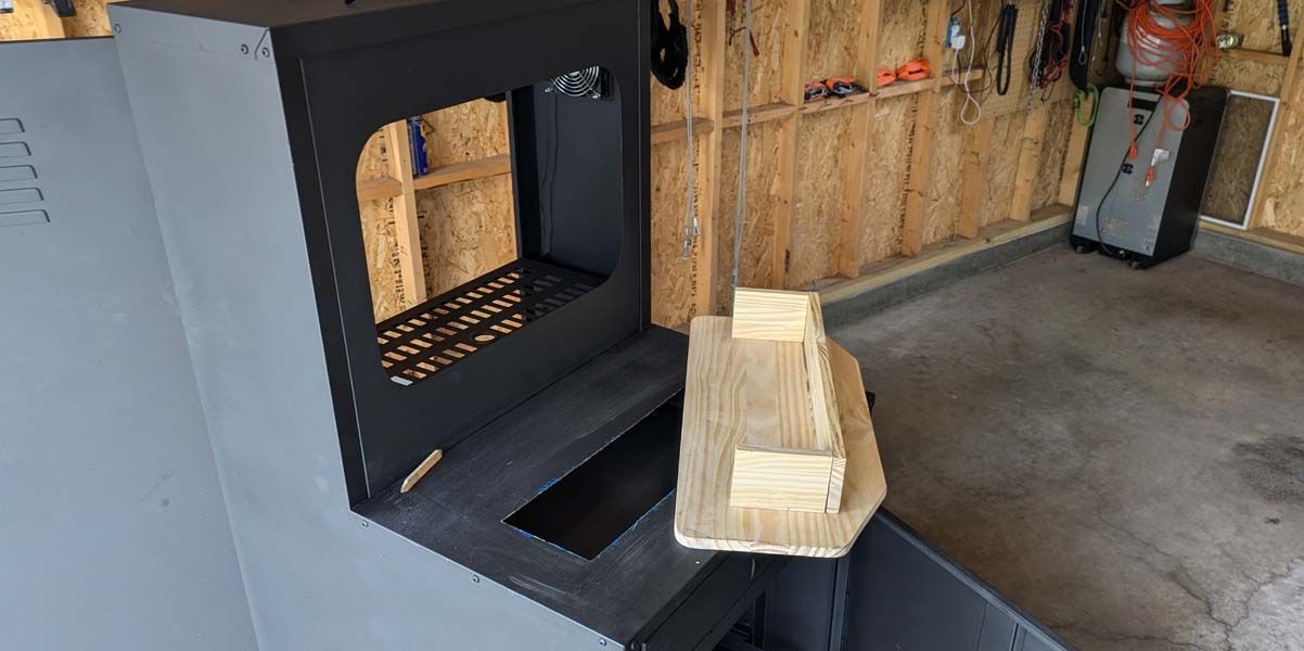

                So it sees both controllers, but does not detect any button or axis input events. I think It is time to just replace them. Ive had them over a year and the more I think about it the more I think I possibly damaged these things. They used to be mounted in a metal cabinet and the opening I cutout for the control panel was very tight. (see attached called "old") old.jpg
                New cabinet.......
                I think its time to just replace the usb encoders.
                Thank you!!!
