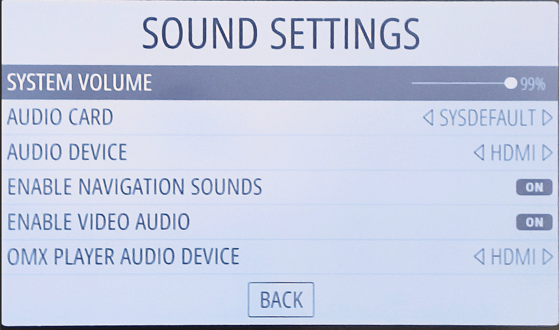

      Also, using retropie_setup.sh configuration/tools/audiosettings I have selected HDMI 1 as output.
      In /boot/config.txt I have uncommented hdmi_drive=2 as well.
      And these are the sound settings on the emulation station:
