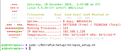

            • aschwanA
              aschwan
              @BuZz
              Just sits like this
                BuZz administrators @aschwan
                @aschwan please try
                cd ~/RetroPie-Setup
                git reset --hard
                sudo ./retropie_setup.sh
                aschwanA C 2 Replies Last reply Reply Quote 0
